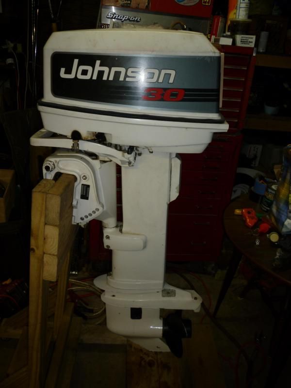

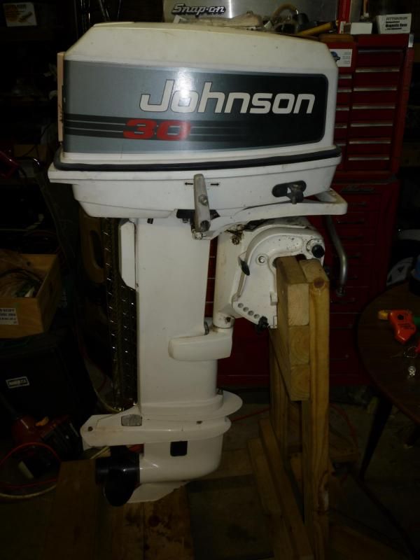

My strong running 30 HP electric start Johnson with controls cost $75. Now I know that I got a great deal, but my point is that you should be able to do better than $450. Unfortunately, it's springtime, and this is the time of the year when prices are at their highest.
