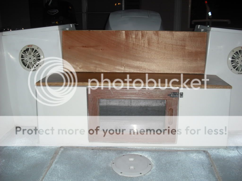

Bench Seat Project
Objective: Simple to maintain, Cheap, and Practical

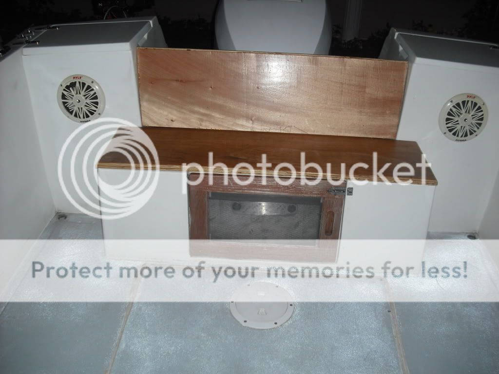

Here is what I came up with using Plywood, Resin & Gel Coat.
Here is my start with Ply laminated in polyester resin 4 coats dry fitted as shown. Gel Coat in progress.
The back will be mounted on SS hinges for easy access to the Motor and tilting etc.
Damm Teak Door look at it after a year in the Florida Sun ..Like my X it needs attention I guess :)

The seats are yours, we will arrange a meet. Thanks, Vic
gonna be sweet with the gelcoat finish on it....going to something with cushions or leave it bare? you're making this resin and gelcoat thing look so easy I need to start making something.

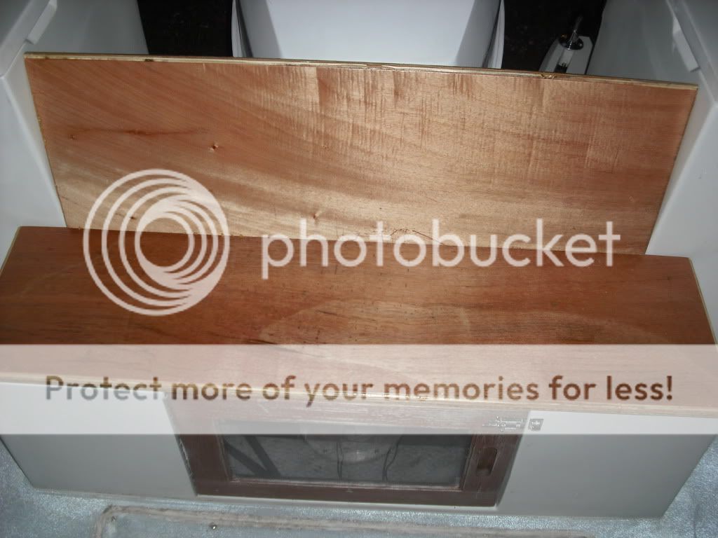

Gel coat is easy don't try to cheat like I did here and over sanded the edges using a palm sander (edges must be done the hard way) I have to re-spray these spots trick is to tape up the sanded area.
As for cushions for the seat I may have something custom done it the fall ..
See the edges ? I remove 20 plus mils and expose the resin ..
I think i would have put some finish cloth on and faired it. Thats a sweet set up tho. what kind of ply is that? Looks like some nice quality birch ply.

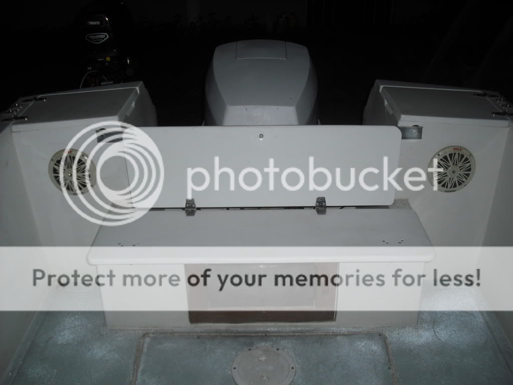

At last..

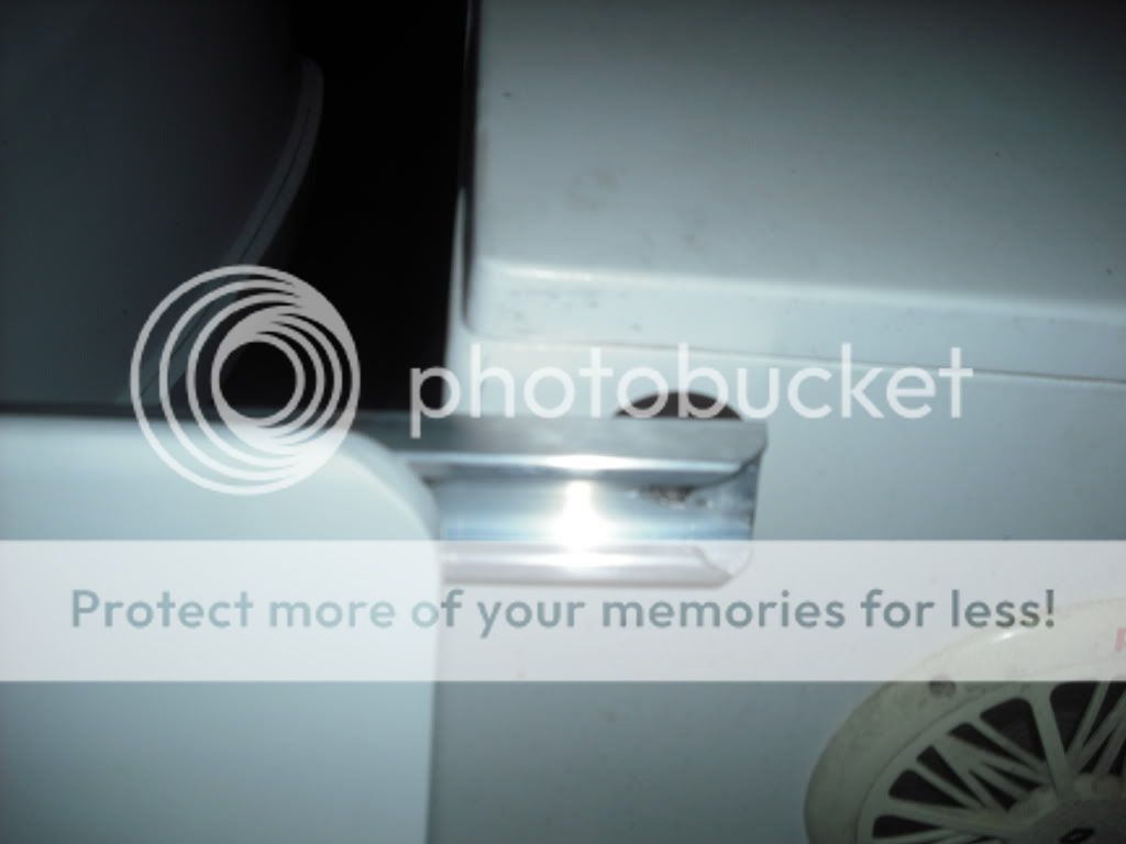

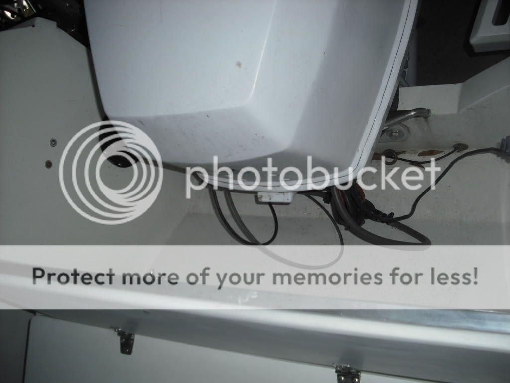

This came out exactly how I planned it , in the upright and lock position the engine still tilt up with no problem , I also add a aluminum support for the back rest, the back rest is locked in place with a wing nut this prevents it from rattling and folding down by itself.

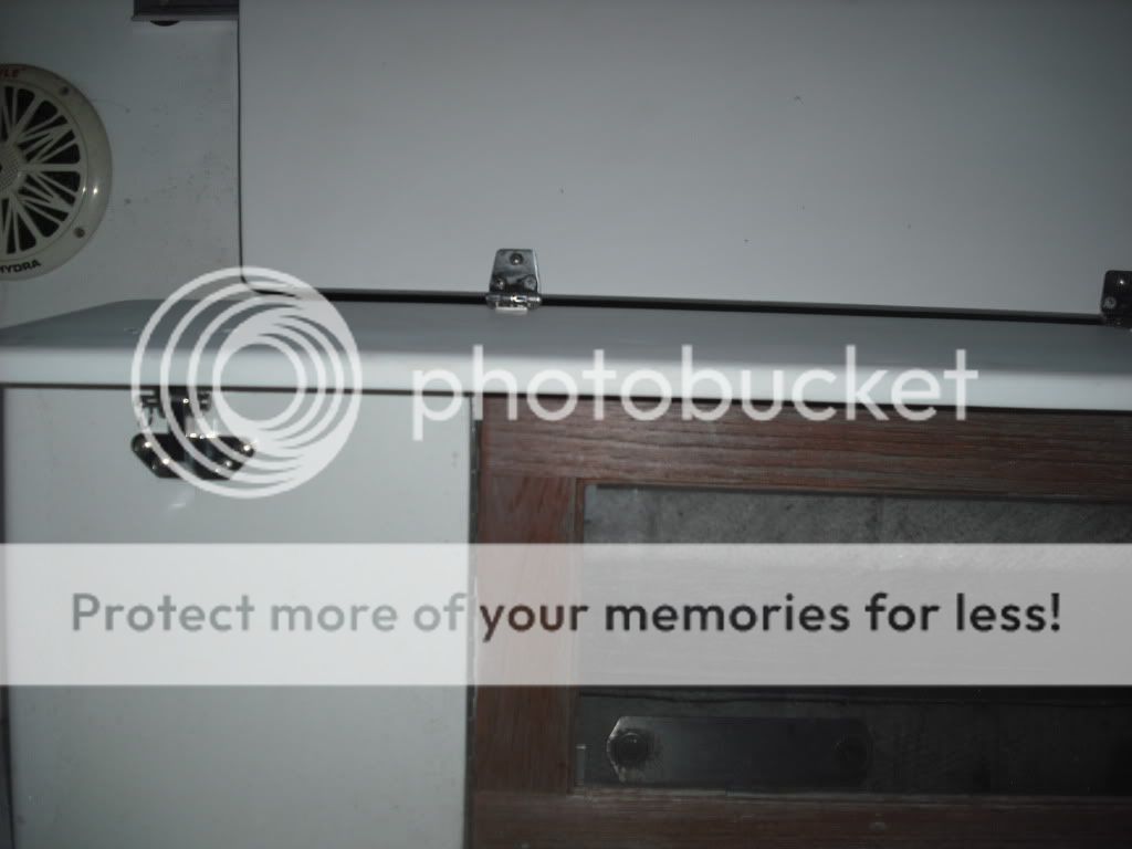

The base is mounted only on two solid stainless hinges I found on ebay it allows the entire seat to tilt or fold forward clearing the splash well completely.

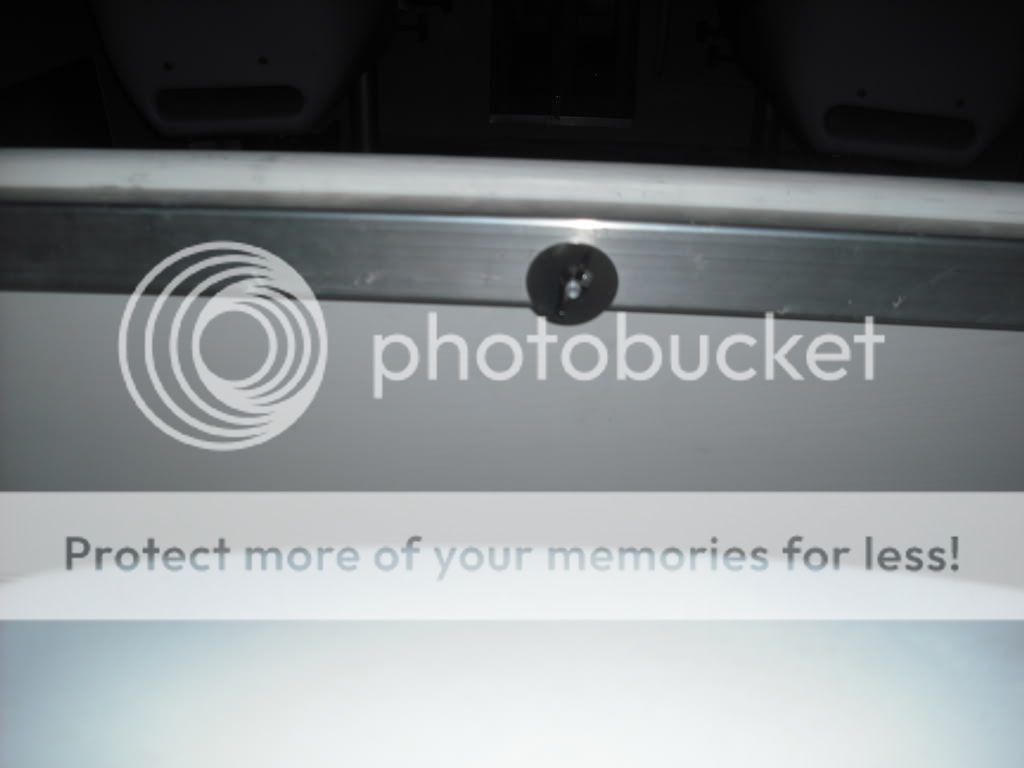

WING NUT AND SUPPORT
Nice mod on the aluminum ..
Sweet hinge ? I can also remove the pin and seat completely
Splash well all clear

Oh yes , I went hunting for those hinges after I saw your post, found em on ebay for 21.00 for the pair free shipping :)
