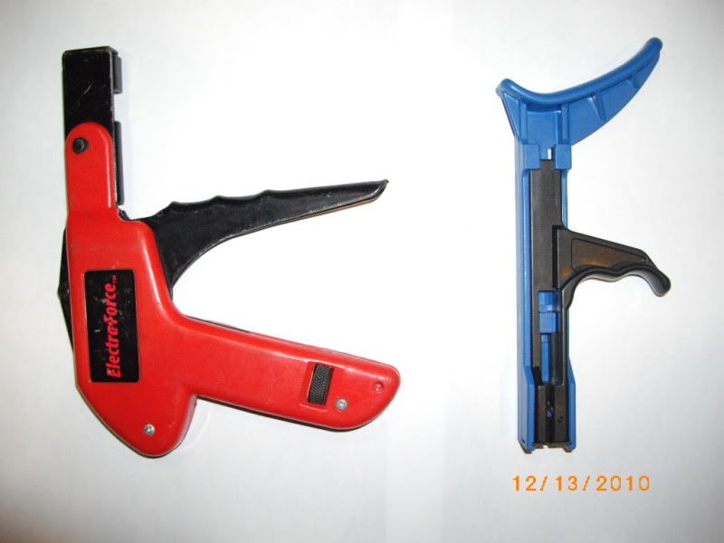

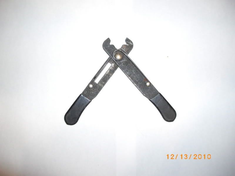

I agree with Bruce on the nylon ties. Three things make the job really simple. One, buy only quality nylon ties. (T&B are my favorites) Two, buy a tie tightener. (Either one is less than $15 at Harbor Freight. I like the red one better, but the blue one is great for tight spaces) Three, buy a wire stripper. The sharp cutters at the tip of the stripper make removing the ties a snap without nicking or cutting the hose.
