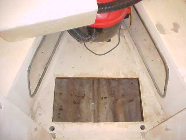

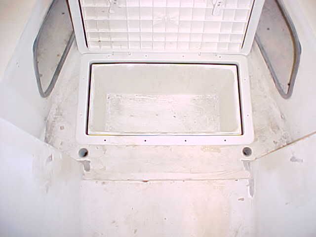

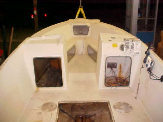

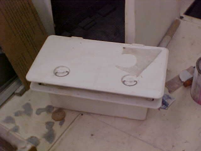

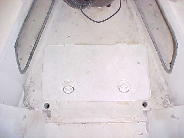

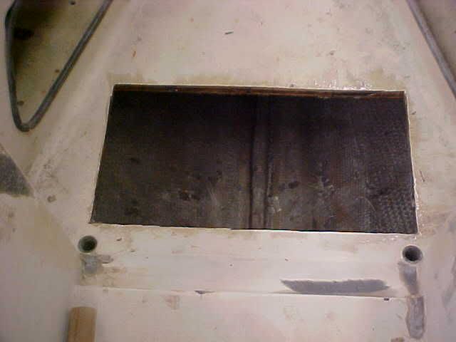

Hey here are pics of a box as you're talkin of i just put in a 21 ft i'm redoing.
Notice in some of the pics where i coated the cut out with epoxy resin. Just mix some resin and coat the wood where cut out with 2 or 3 coats of resin. Then seal new box in with 5200 or Clear 100% Sealicon. This hatch with drop in insert was bought from www.boatfix.com Cost around $50 with drop in box. Before you cut out the floor must look under to see if there are stringers there.
Thanks for the replies guys. Hey Skools - about the hatch you show in the pics. Thats exactly what I was thinking about. But - I dont want a hatch lid that will stick up to much ..... stubbing your toes on, tripping over, etc. How is the hatch you have - would it be ok to walk over in the back area part of a V20 deck ? Is that the Beckson or TH Marine hatch ? How did you get the storage box and hatch for around $50 ? The hatch alone looks to cost that much. Brian
Brian, I have an 83 and the tank is in the aft and fish box in the middle with the "dead"area forward. My deck rotted out becauseof the way the pedastal seats were installed and I had to remove the deck from the cabin to the fishbox. Like you, I noticed a large hole and no way to get to it, so When I replaced the deck, I installed the Tempress cam hatch. Everybody is giving good advice . Seal the raw edges , It is "dirty" storage, all of the debris and water from the cabin and the bilge will slosh through there. I keep fenders and a bucket with bait nets and mullet nets down there. The only problem I have had is the hatches don't hold up to the traffic. Where mine is , when you come of the bow, you land on the hatch. Guess I could try going starboard. I love the storage and also can access a normally hidden part of the bilge to clean and inspect
