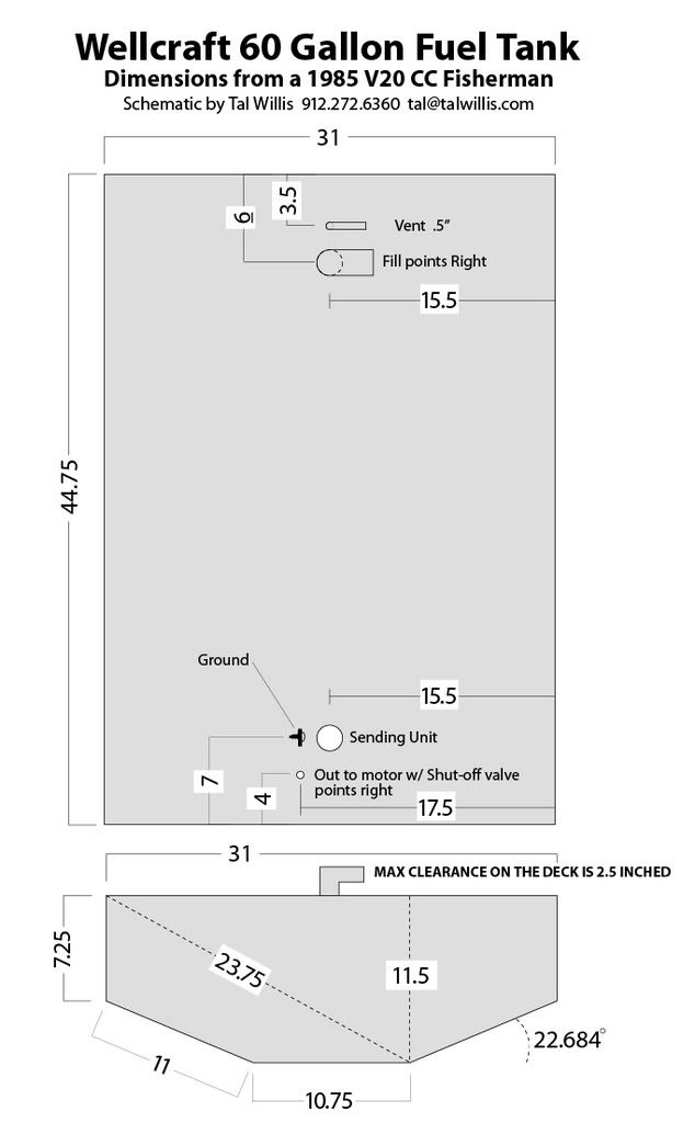

I thought I would be a good thing to start something like this.
This is from a 1985 Wellcraft V20CC Fisherman. I have the plans drawn to scale and this reduced version as well. If you would like a higher resolution file to print, E-mail me and I'll send it to you for $50. Send self addressed envelope as well.
just messing around. It's Free.
That CC tank is identical to the one used in the 1984 cuddy. I could have used that data sheet when I replaced my old fuel tank. I installed a 24 gallon permanent plastic tank in the live well (forward of the main tank) as a temporary tank until I could replace the leaky 60 gallon tank. Now I have 84 gallon capacity and about 240 nm range. The only problem I have with all that fuel capacity is that I have to think twice when I say, "fill her up"!!!
Geek
In addition to the above reply, I have done alot of on-line research on replacement fuel tanks suitable to replace the original Wellcraft 60 gallon belly tanks. Most of the replacement cross linked polyethylene belly tanks made by Moeller, Todd, etc. cannot be used to replace the original 60 gallon tank unless the V20 is seriously modified or the fuel capacity of the replacement tank is seriously reduced. The reason for this is that the replacement plastic belly tanks bottoms have an angle of about 12 degrees and the V20 has a deadrise at the transom of about 23+ degrees. The angle of the V's bottom and the 12 degree angle of Moeller, Todd, Oceanlinc, would mean that any ready made belly tank over 29 gallons will not fit unless you raise the hatch about 3". The 3" would be for a 42 gallon belly tank. A 55 gallon belly tank would most likely require the hatch be raised even more. The length of these ready made plastic tanks is also a problem because most are over 45" in length and it would require modifying the bulkheads to accomodate the longer tank fore and aft. I am using my standard 84 cuddy outboard V20 as the model for below floor space. My old tank is the one shown above.
My conclusion is that if you want to have your main tank to have a 60 gallon capacity, you need to have a custom made tank fabricated to match your old tank or reduce your fuel capacity to about half. There may be a ready made tank out there that may fit better but I haven't found it. I hope this helps if you get a leaking tank and you need to replace it!

Good price!!! I paid $100 more. No shipping. What thickness aluminum?? Are you using your old sender?
Most of the Moeller and Todd plastic belly tanks are not that much cheaper than your custom fabricated tank!!

It is strange, the tank seams to have the same dimensions,
but I didn't actually measure it.
1984 center console dimensions different?
just thought i 'd tell you that my 1984 center console fisherman 60 gallon tank dimensions are completely different from the 1985 one that is depicted sooo just be sure before you order your tank!!! my 60 gallon tank is 60inches X26 inches , and 11" high without the fittings.

geekie1 i am trying to replace my aluminum fuel tank in my 84 fisherman centerconsole and am trying to find a suitable aftermarket PLASTIC tank only. is there one you have discovered that is close to 60 gallons? for the 20' centerconsole. i've looked at the 55 gallon moeller tank FT5599 tank but am still not sure if it will fit properly.

Here are my measurements for an 82 cuddy. 60 gallons.
