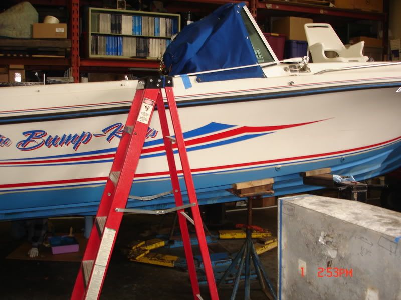

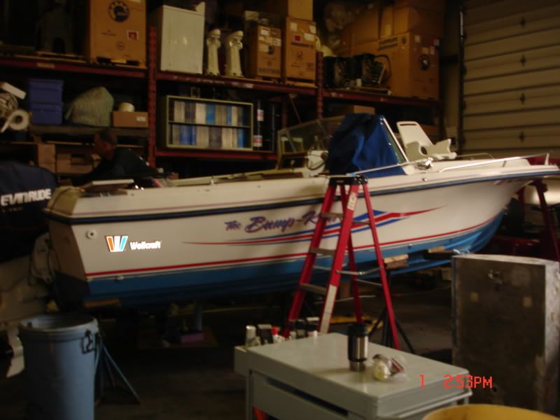

Had water in my tank, decided to remove it today. What a pain chipping away at the foam, but got it out with no problems.

found some holes
Foam destroyed the tank as there was water in the foam like a sponge.

removing foam
Foam was a pain, chipping away with a crow bar, prying pieces off. The foam was saturated with fuel and water making it heavy.
