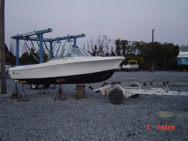

Back at the boat yard waiting to come home.
