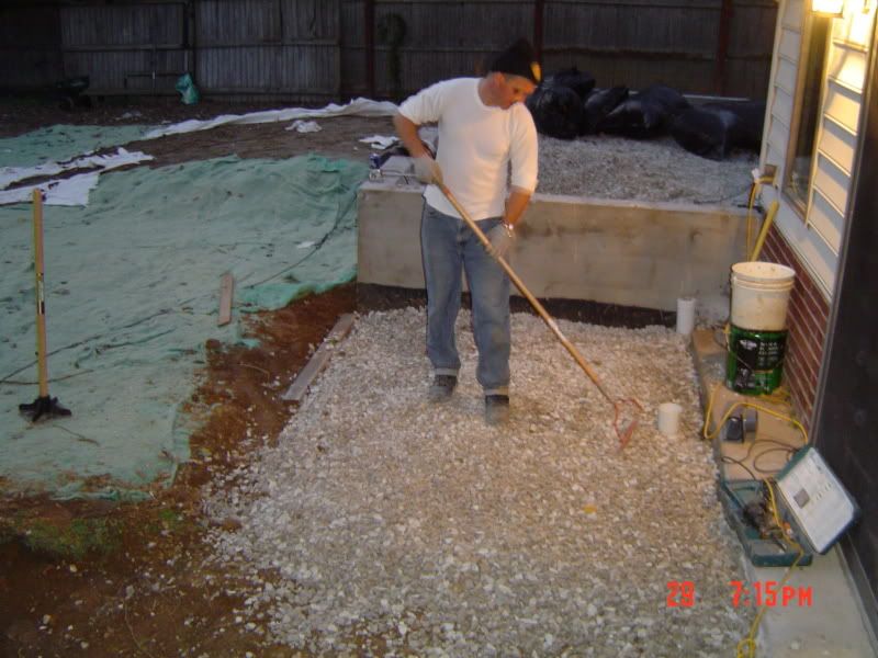

Putting in the stone for the rear pad.

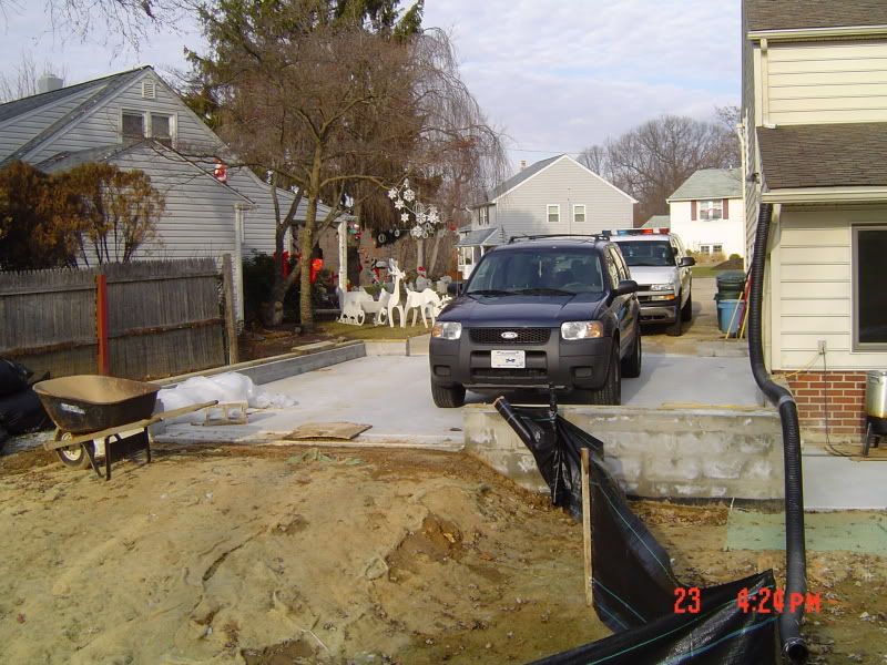

Note the siding hanging. YES, I hit the side of teh house with the tractor while digging. But I gotta take the siding down anyway. Twp. wants fire proofing drywall installed on that side.

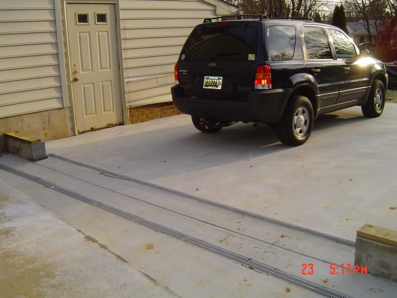

Pad with my drain system installed. Great investment.
During heavy rain, the old pad caused water to run towards the house instead of away from the house. The new pad slopes away from teh house, but to play it safe, I invested in a drain system as well. No more water into the read addition.
Did the same thing on my garage.
