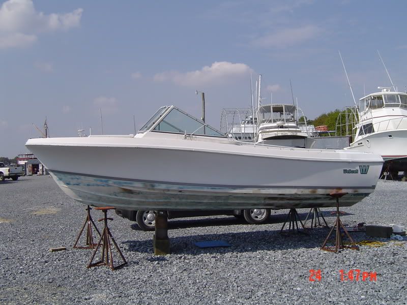

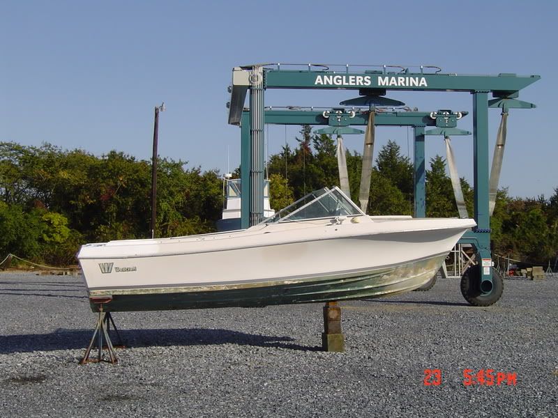

30 years of bottom paint.
Bottom sand blasted.

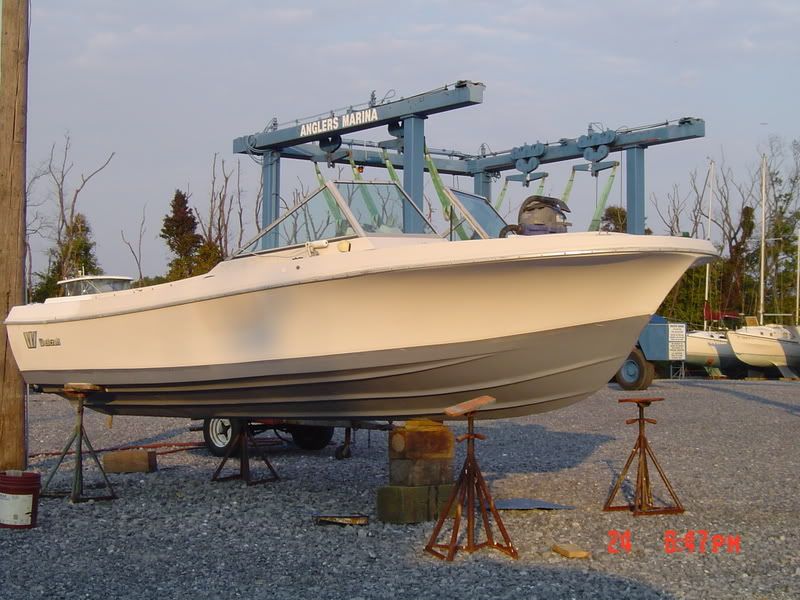

First coat of Petit Barrier coat. Looks good in the picture, but I seen some spots that I wasnt happy with.
Not happy with the results of Petit barrier coating.

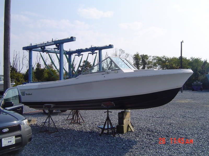

Went out and bought Interlux 2000E barrier coating and applied same. Also filled in some pitting from the sand blasting.
Filling in some more pitting from the sand blasting, that the Petit barrier coating was suposed to fill in, but didnt.
So I filled in the pits, but also adding in the 200E Interlux that works much better.

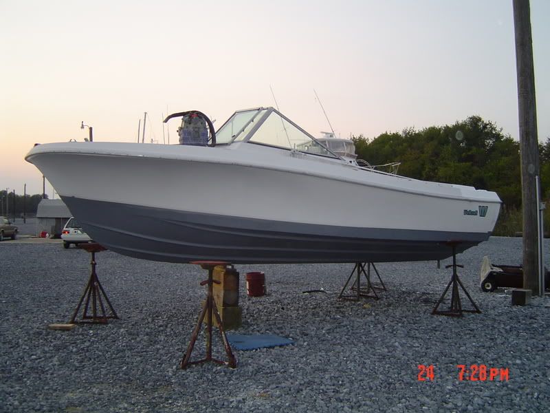

Will have the bottom paint on in the moring. Gonna do a quick sand then finally get the bottom done, then decide if i should boot stripe and decal it or wait and paint the sides.
I did get teh bottom paint for free from a fellow boater. Some type of Interlux brand. Priced at 199.99. So I did save money there.
She will look better once teh bottom paint is on. Once teh hull is done, I guess I gotta move onto redoing teh fuel hatch cover.
Got off from work at 6am and went straight to work on the V. Finished sanding and put on the bottom paint. Will move the jacks and touch up and teh bottom will be dry. Not sure if I should put on the boot stripe and Welcraft decals or paint the side. The sides are chaulky, but I brought the shine back in on one spot with some compound.
