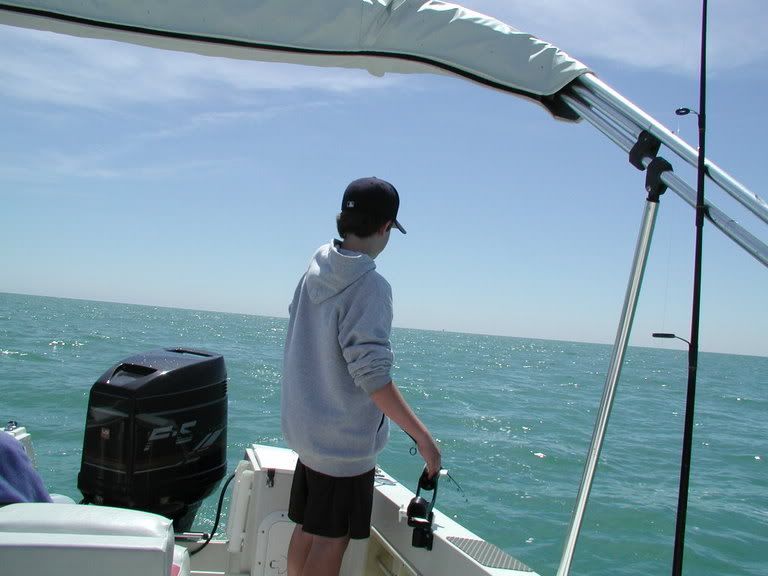

Dog, Just something to keep in mind when looking at this '86 vs the '89 you mentioned. Wellcraft made a change to the floor in '88 I believe. They raised the floor up a good 2-2.5" in order to get a self-draining (overboard) cockpit. Might seem minor, but to me it is a big difference. I definitely prefer the deeper sides of the '86 - even if it means having the cockpit floor drain into the bilge. When your legs are leaning against the sides ... fishing in some rough water .... that extra 2-2.5" makes a difference - to me anyhow. However, I trailer. If you slip your boat, the overboard draining cockpit might be your preference.
Good Point BrianCT12, i was actually just checkingout which years were self bailing. I didn't know that the floor was lifted that substantially. Got to think about that one. I might think self bailing is more important in rough seas but i wouldn't want to fall overboard either.
I don't care if you have the extra 2 -2.5 inches, if its that rough that your worried about falling overboard sit down or go into port. Mine is a 1990 out board version cockpit drains into splash well.
Photo of my nephew who is 13yrs and about 5'6".

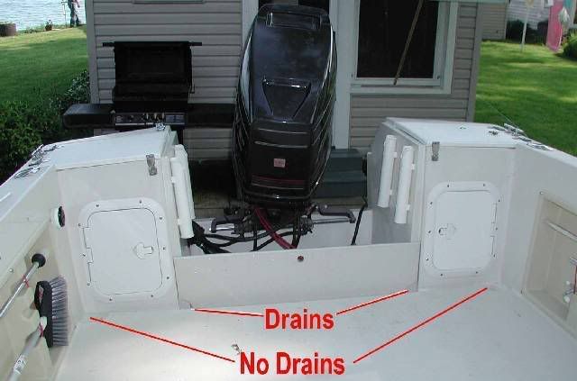

Here's a photo of the drains. There are no holes in the corners. Water drains along a channel at the base to cut outs in the splash wells splash guard. Skools what is that board called? Billy Mac ;D

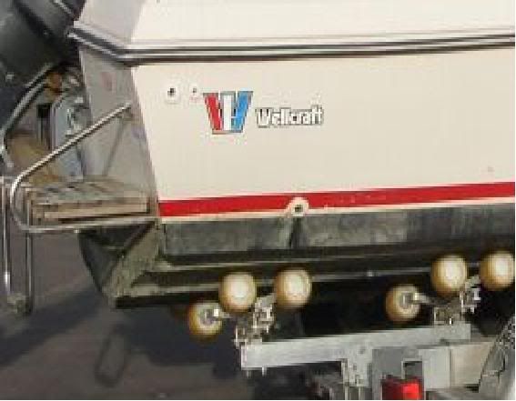

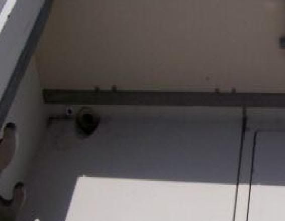

right CB all after 78 were self bailing, if someone hasn't removed the drain hoses should be deck drains in those two outside corners hum??? do it like this here a V20 with them plumbed out the sides

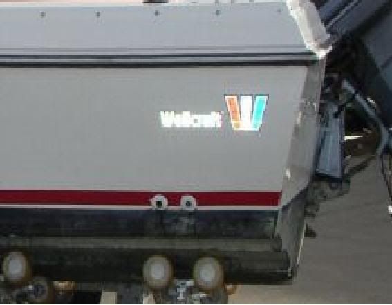

here's a 250 in the back that goes to those side type drains as well
That's how i'm hooking up my deck drains is out the sides
I have no problems with the way it is, Just that the scupper holes in the splash well are right at the water line and below when I go to the rear of the boat. Billy Mac ;D
