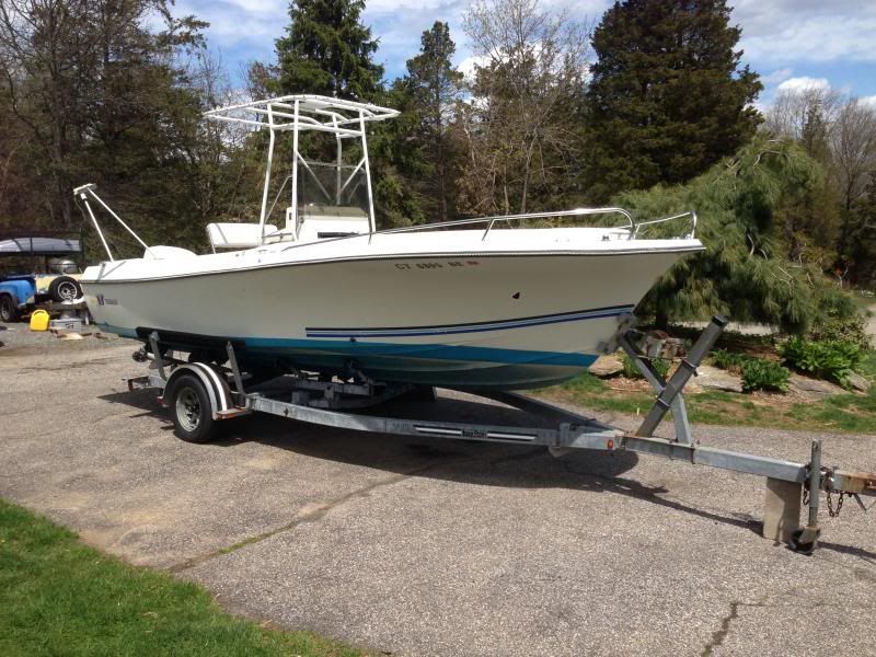

I have been wanting a Center Console for a long while. I found one last month with a painted aluminum T-top and a galvanized single axle trailer for $1300 and bought it. The T-Top is what sold me. Here it is before I started work on it.

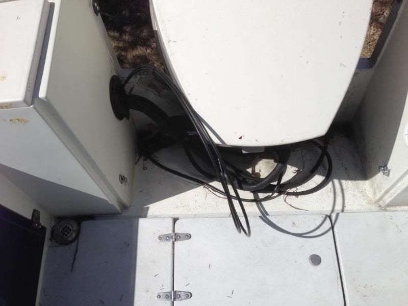

My big question is the transom. It appears solid, I plan to pull off some of the trim and check it out. There are not splash boards, but there are a few hooks to hold a board in place. It appears the transom was cut down from 25" to 20" to accommodate this motor. This concerns me. The previous owner tells me it was not a problem. I can fix this although it would be a fair amount of work.
You can see the notch cut in the transom in the below photo.
Do I need to be worried about the boat being swamped from the back?
Could this possibly sink the boat?

First, from one vet to another,thank you for your service. Second, welcome aboard. It's hard to sink these boats. (not impossible, just hard). I'd make sure I had a splash board in front of the engine well. (why invite trouble)

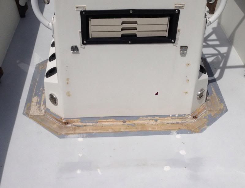

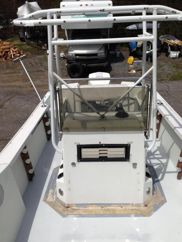

Here a picture of the console. The Wellcraft tank is not leaking--now anyway. The PO told me the tank was fine and that it is full and stabilized and mixed 50:1. So pumping out 60 gallons will be take a half a day. I'll need a drum to put it in, and maybe a couple of 6 gallon jugs. That fuel is worth $240 right there. I have a 20 micron filter on my
DC transfer pump so that will scrub the fuel. I also have cables to ground everything
My helper Marco and I can get the tank out in a day if I first remove the fuel and grind out the tabbing on the console. I might take the T-top off to, so I can repaint it. We have both done lots of this sort of work. I am not afraid to cut up decks or drill holes--that is what stops most people.
So any way, in these pictures you can see someone taped up the edges of the console. I took a peak in an access hole and what I saw doesn't look great. I'm going to stuff a camera in there and get a better idea. I am guessing the tank starts at the front of the console and goes aft to the helm seat? There is a seam sealed with silicone that looks like it was meant to cover a tank. If the tank goes farther forward than the front of the console, then this is definitely the original tank. Can anyone clue me in on that? Where is the front edge of the tank?

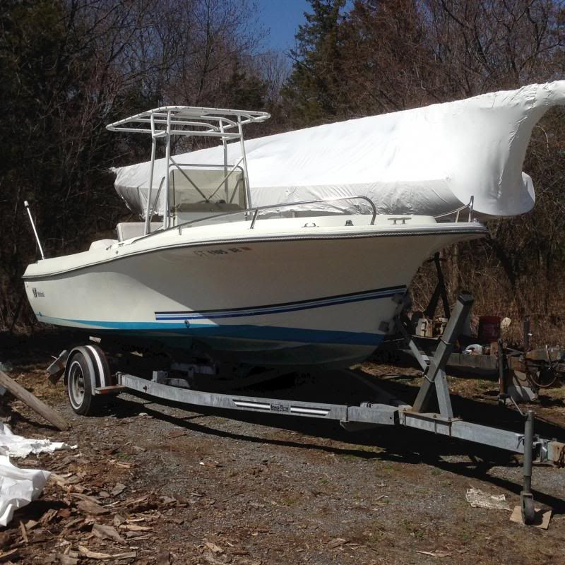

more pictures.

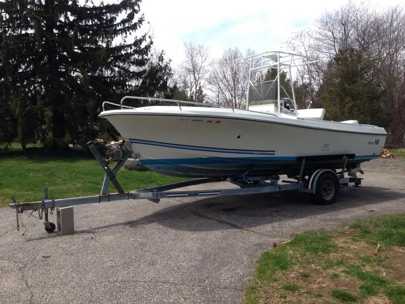

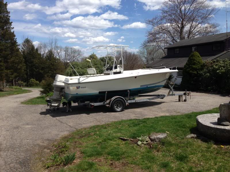

Here it is with the trailer reworked with new springs, hubs, tires, lights and wiring. I wet sanded the top sides and it cleaned up nice. Black mark is a cacamera defect.
The black mark on the topsides is from my camera.
I added the guide boards, and immediately regretted them. I think I need something higher than these.
Looking good. I like the looks of her. My boat is a trailer queen also, and there are lots of us here that keep them on trailers, so you're not alone.
As to your question about the 4 strokes, I have no numbers, but from what I've heard they are typically about 1/3 cheaper on gas for the same miles traveled. People like SpareParts or TheFermanator can probably give you better figures than that, since they work on them professionally.
As to your need for speed, I can tell you that my V20 with a 225 Johnnyrude can hit 50+ on a calm day, properly trimmed and with a light load, so you can wave at those 1/4 million boats as you pass them.
