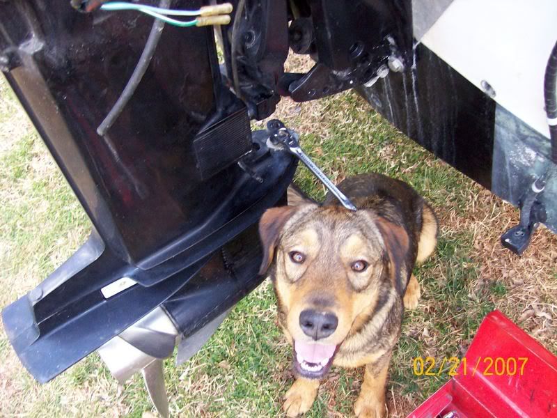

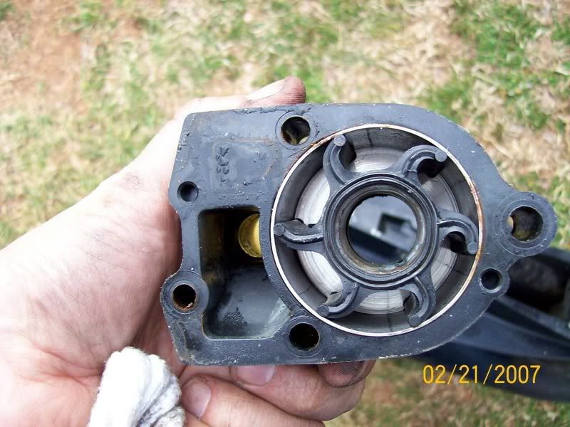

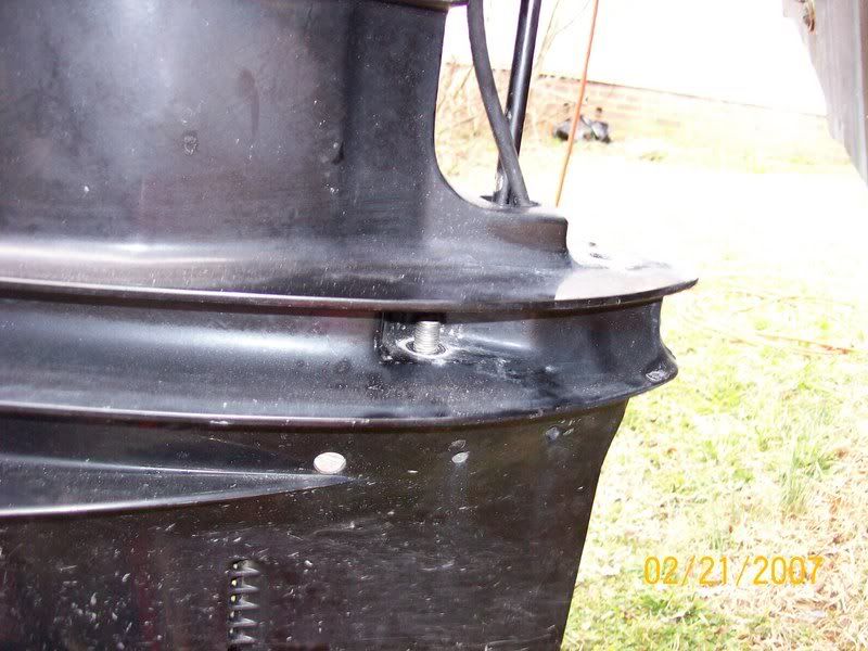

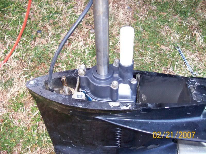

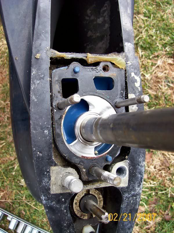

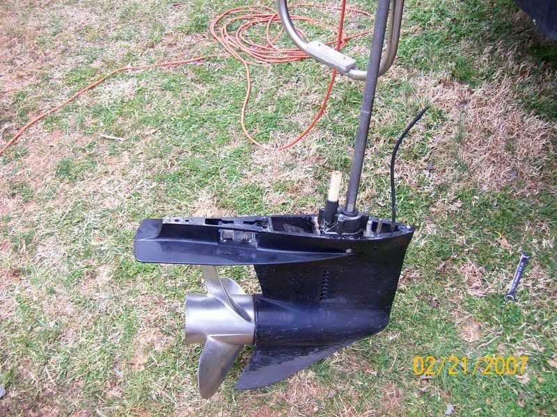

On an ALPHA to do the water pump it is pretty much the same as a MERCURY outboard. You don't have to pull the whole outdrive off, just drop the lower from it. You have to remove the trim zinc to get to the hidden bolt, and make sure it is in forward before dropping it. Also drain the lower before you drop it down as the upper and lower use the same oil and you will have a mess if you don't drain it first. Also make sure and install a complete kit with base, and don't forget the little square o-ring that goes into the lower for the oil passage.
