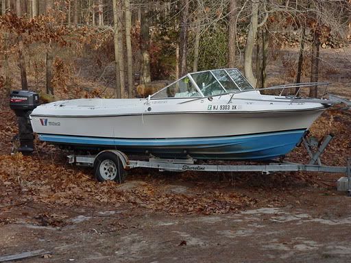

Since this boat has a full transom, and the previous owner put on a bracket, and took out the old scuppers. I'm looking for suggestions on the proper placement of the scuppers. Seems like the bracket gets pretty wet when I'm trolling. So beneath it could mean water on the deck.
Vic,
do You have a pic of what the prior owner did to the scuppers?
My 85 was a sea drive converted to bracket and the scuppers drain out tubes to the sides of the boat. I think this was the stock position with the sea drive? I dont understand what or why your prior owner did to the scuppers??? ???
Vic,
you can see my scupper drains in the rear corner at the waterline.
Thanks Fillet, Thats perfect exactly what I needed. I dont understand either. That looks like a good place for them. Does it stay pretty dry?

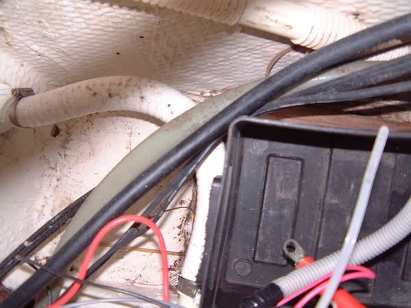

Fillet, is there a 90 degree turn in the hose running from your bulkhead scupper to the through hull fitting? I'm just wondering how that keeps from getting clogged? I was thinking about running a hose from my bulkhead scuppers over the battery and oil tank shelves directly into the bilge, but didn't do it because I didn't want to create more problems from clogs.
CT-
There is a bend in the hose, but it is gradual and not a hard 90 degree.  You can see how far back the thru hull fittings are on the boat. When looking inside the transom at the hose, it runs aft to almost the corner of the hull.
I'll get a pic or two of it from the inside when I get a chance

Vic, I replaced the scuppers in my boat with Brass Bar drains. Same size as the original equipment. They come with a threaded nipple that I cut off and I put a street ell to make a fast 90 to go out the side. The clogs aren't bad, the worst thing is the little plastic caps on the tops of water bottles. If your in the hood stop and look.
Nice picture fillet. Same set up as mine except I just let the water drain directly onto the shelf and into the bilge through the cut out on the shelf. Might want to double clamp that hose since it's on a thru hull. If I do the hose, I'm going to send it directly to the bilge rather than through the hull. We'll have to check back on it at the end of the season to see how you like your set up after fish guts, leaves and other junk passes through there.
