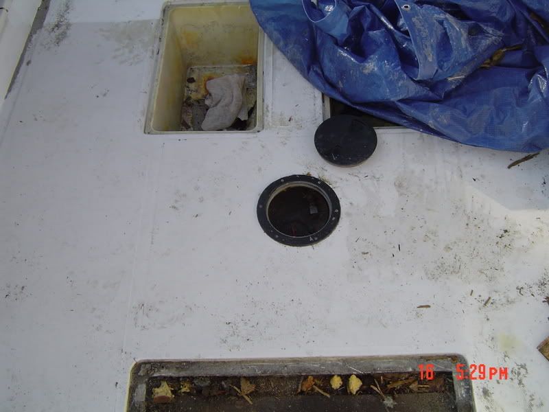

Ok, this is the next project to do. Gotta cut out this section of the deck because it's soft. I think its because the fuel tank is under it. >:(
As far as the tank goes, gotta figure out if the tank is good or not. Any signs to look for besides gaint holes ???
Gonna cut between the two stringers and between the bulkhead, screw in the new piece of wood to the stringers, along with using West System to resin the new wood to the topside and underside of the skin.
