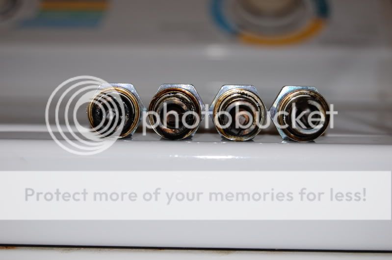

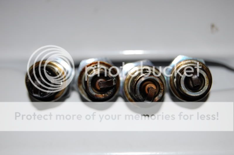

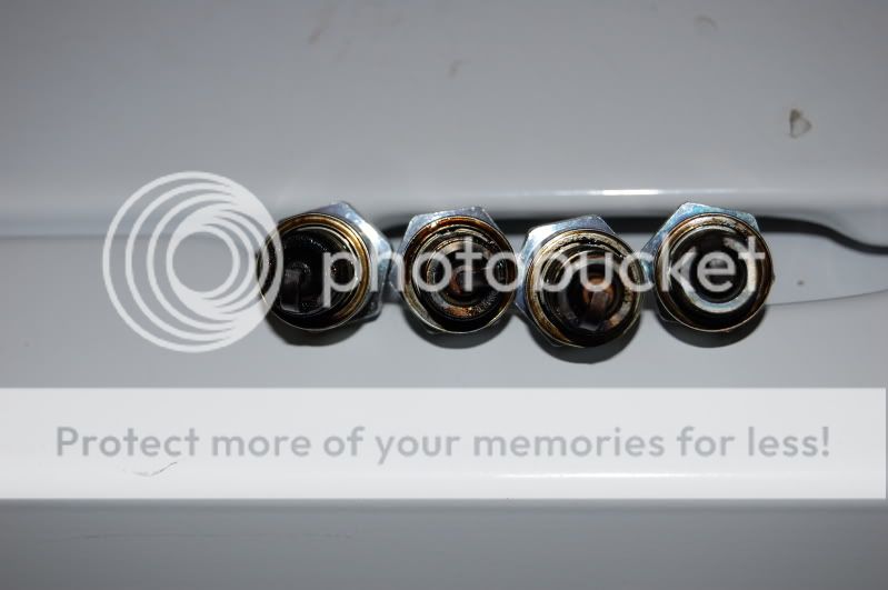

I pull my plugs for a check and here is the results. Plugs pictured are left to right 1234 , One and Two clearly shows some excessive oiling, I am not sure about three and four.
These are NGK Plugs gap at .40. In my opinion I will not use em again , I notice they run COLD at WOT around max 130 degrees. Reason for the oil on the plugs ?

In the mean time any thoughts on the condition of the plugs? Should I be worried ?
What had you been doing with the engine prior to pulling these? If idling and no running above 1500-2000 then #3 concerns me the most followed by #2. A looper should be almost black and slightly wet at the plugs from idling, and burn a brown color when running along. How many hours were on them? The whiteish on #3 would concern me as that is signs of a lean looper. And a lean looper will run like a scalded dog, but not for long. Run the champions and check them after a few mid range runs. Also try running her at 4500 for about a minute and shut her off, then go back and pull the plugs and check em. Cruising and top end is where jetting is CRUCIAL on a looper, idle is hard to judge as a looper is pretty ineffecient below 2500 or so RPM's. The older engines actually do better at idle, but from cruise on up a looper is the winner.

My second to last run was WOT for about 30 plus minutes then idle to port about a 1/4 mile, my last run was 8 on board no WOT just maybe 4000 for 5 minutes then idle 1/4 mile to port.
I can literally smell and sense the engine loading up during the idle to port both times if that helps.
I will give your test a try and post the results .
