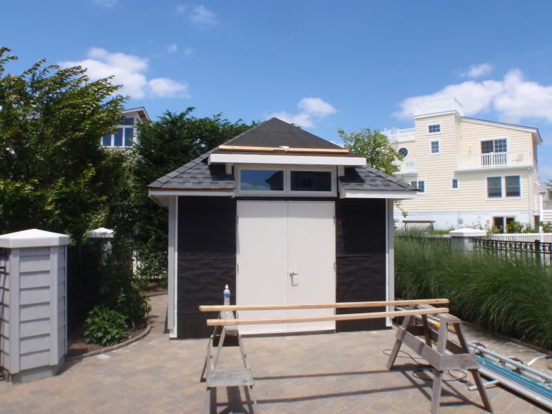

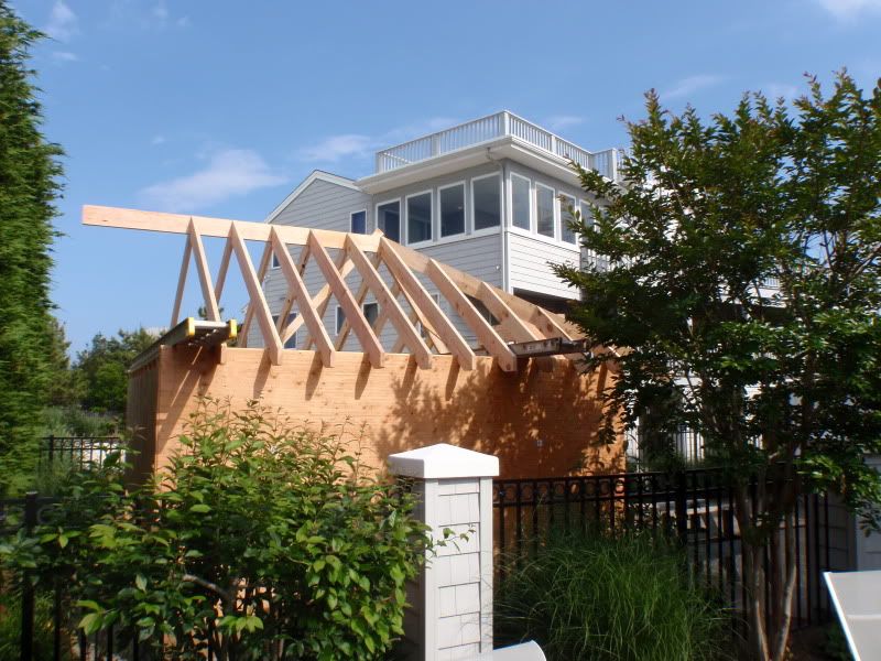

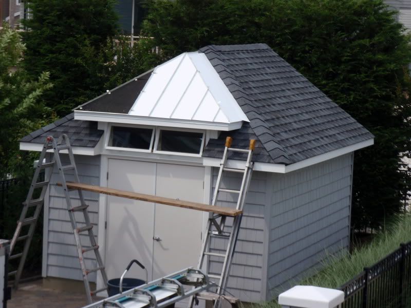

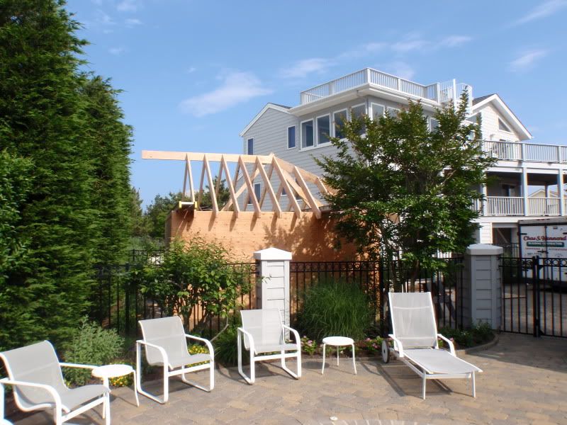

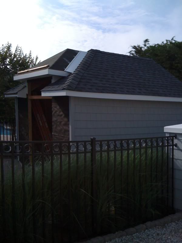

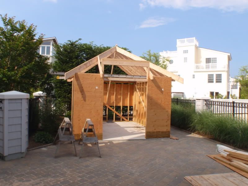

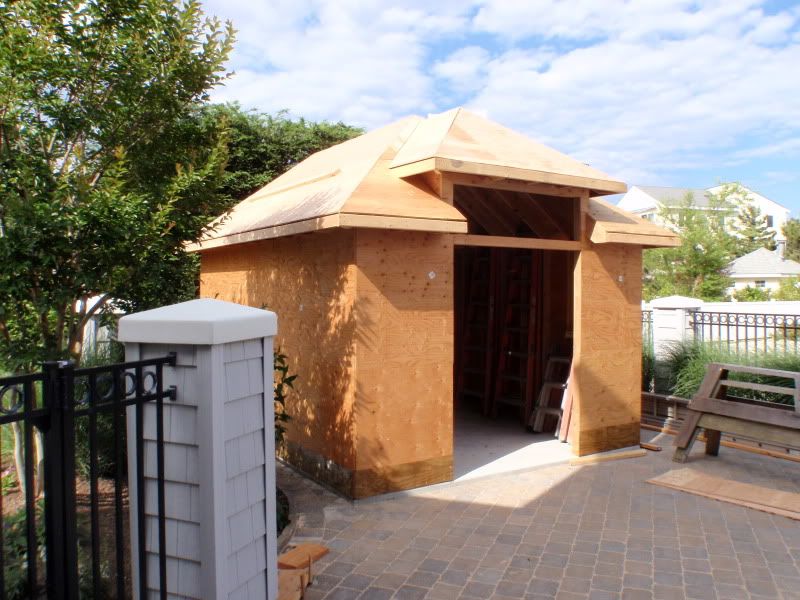

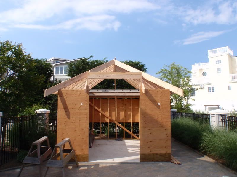

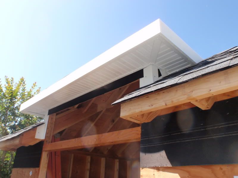

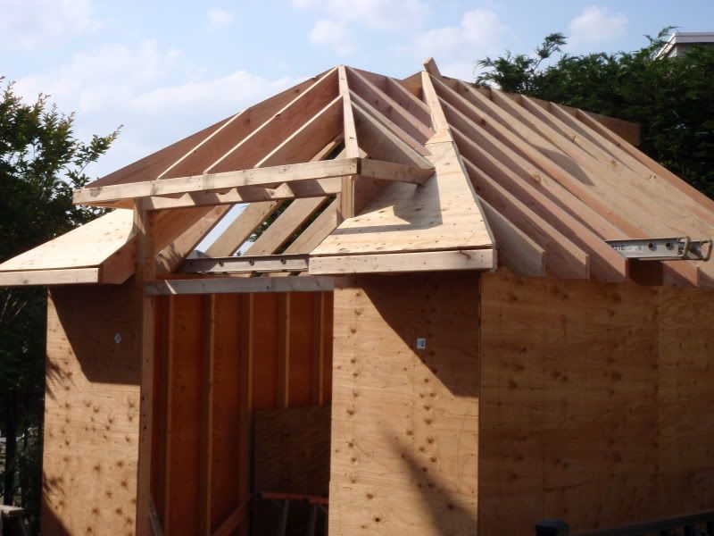

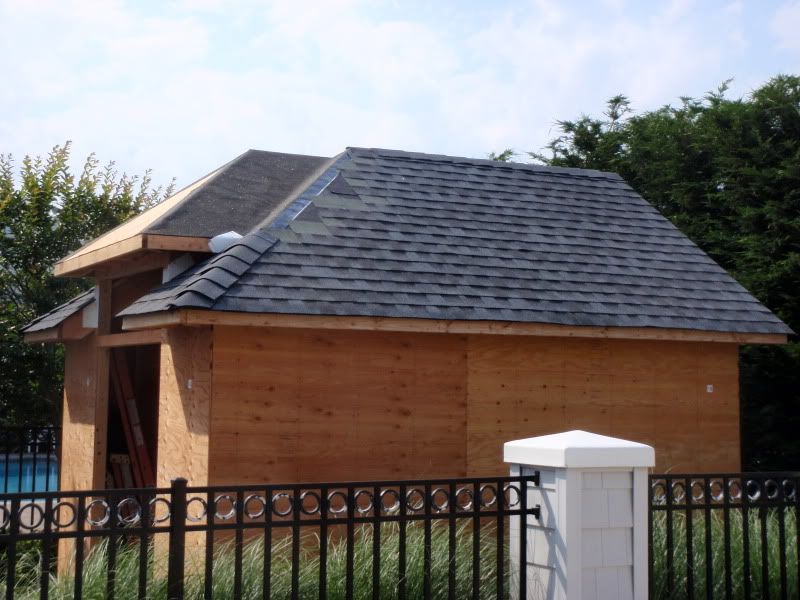

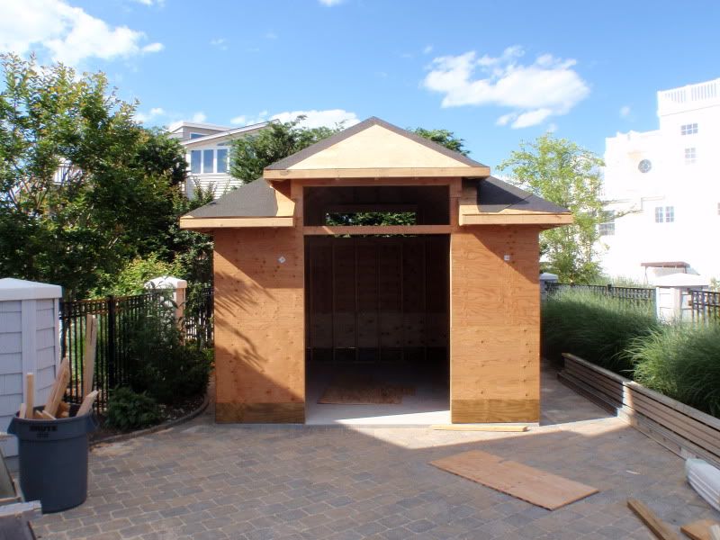

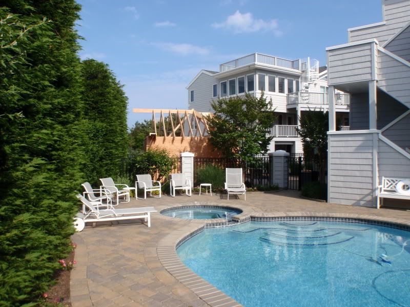

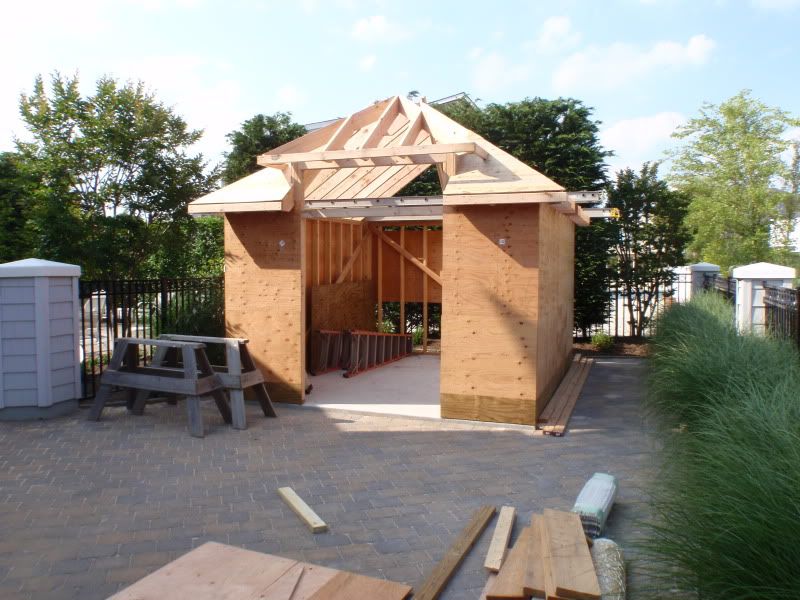

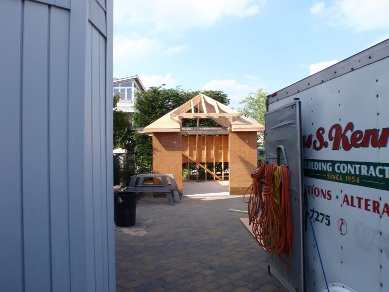

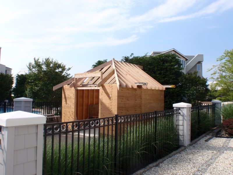

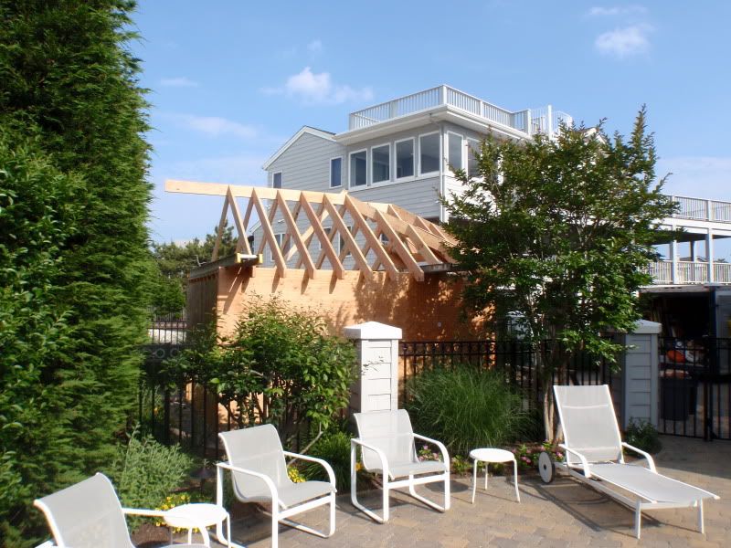

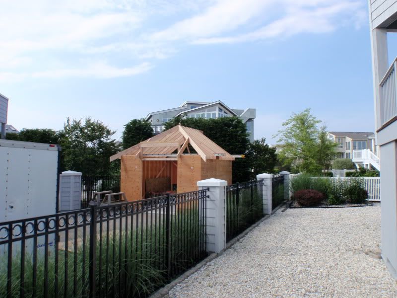

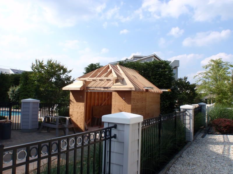

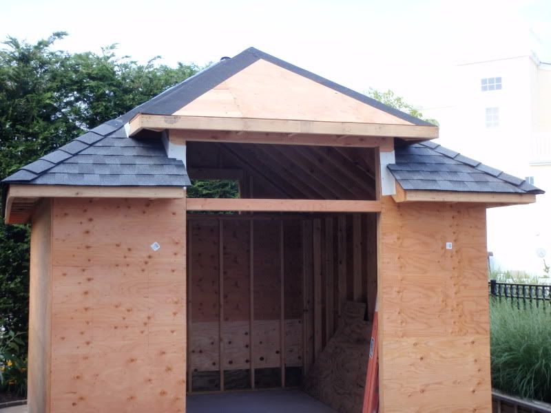

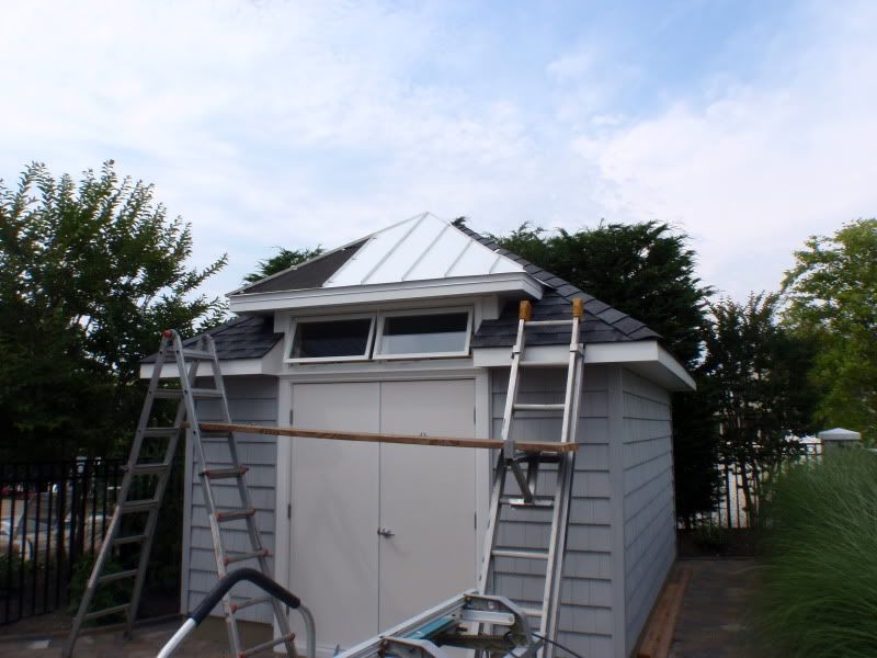

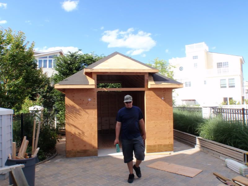

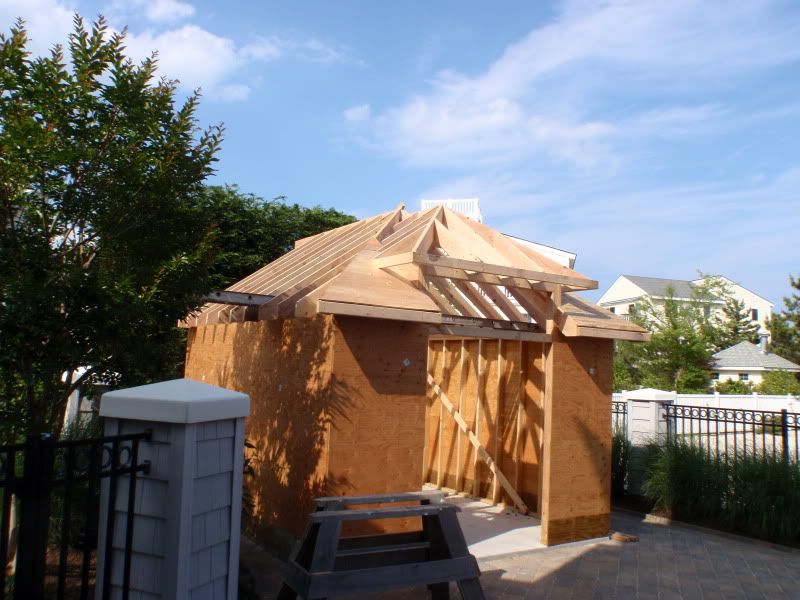

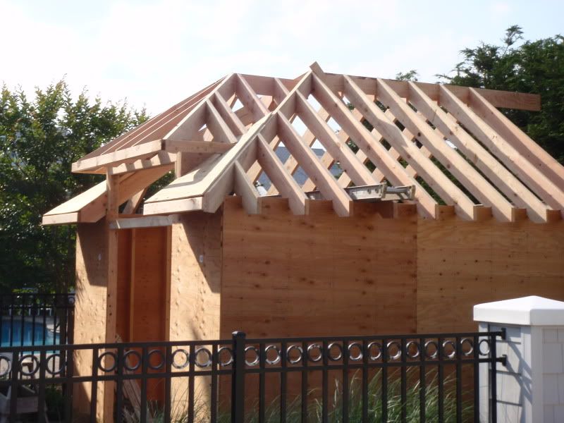

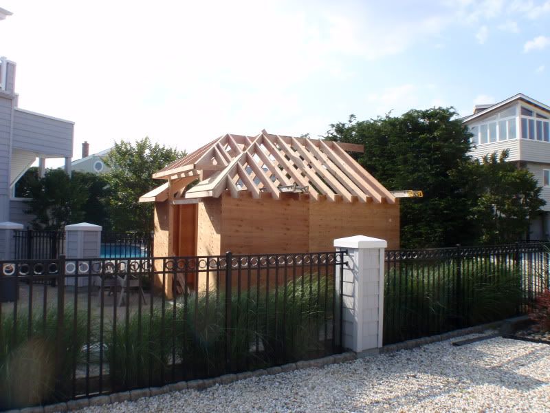

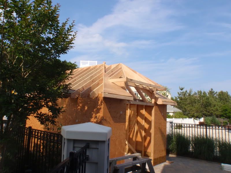

Started building a pool house in loveladies one house from the bay.

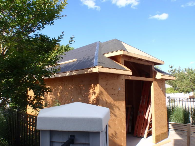

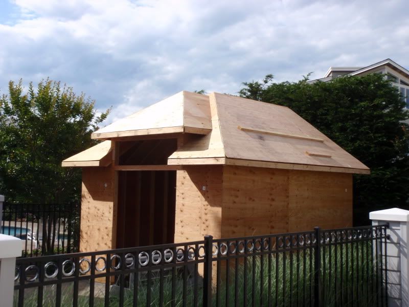

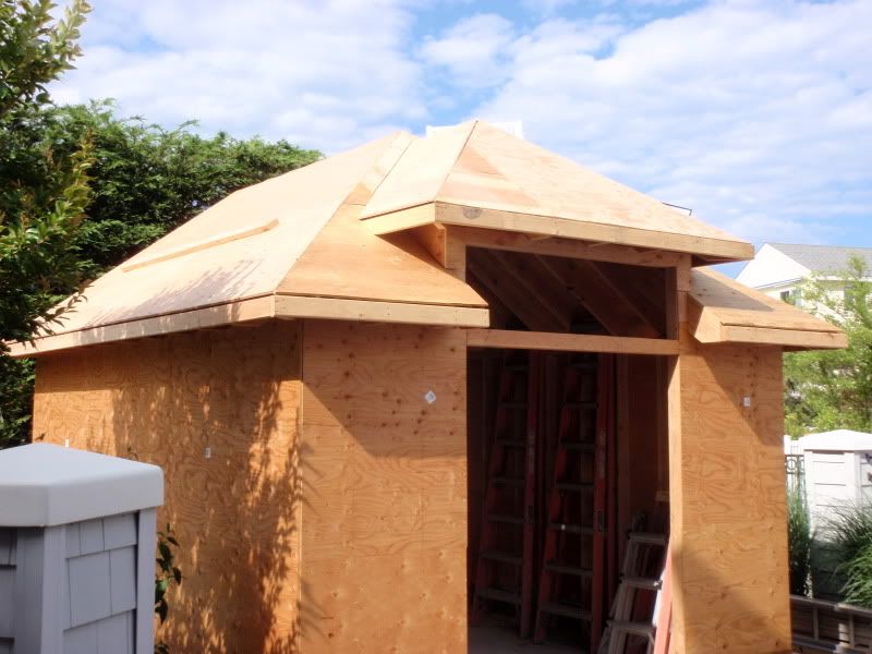

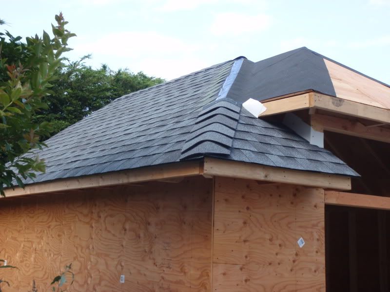

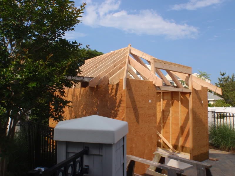

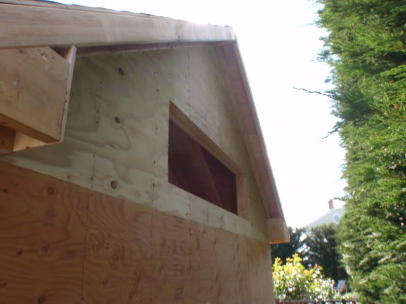

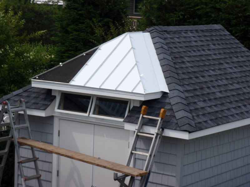

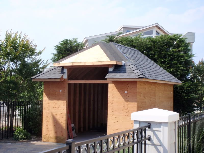

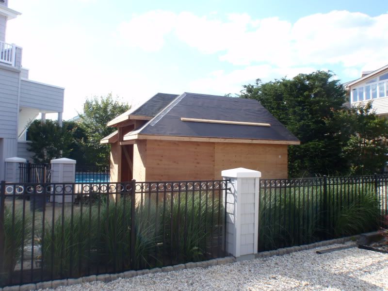

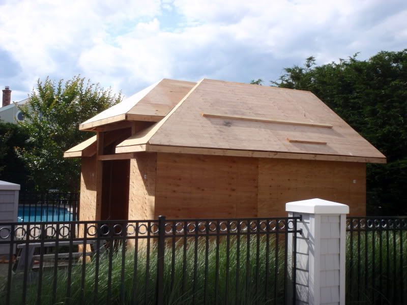

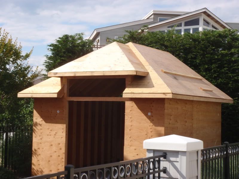

That is interesting, it seems the rafters from the lower ridge up front are fastened to the hip from the main roof. I have never seen it done that way, how is the valley where the two roof lines meet going to be framed?
Just curious, The framing looks great though.

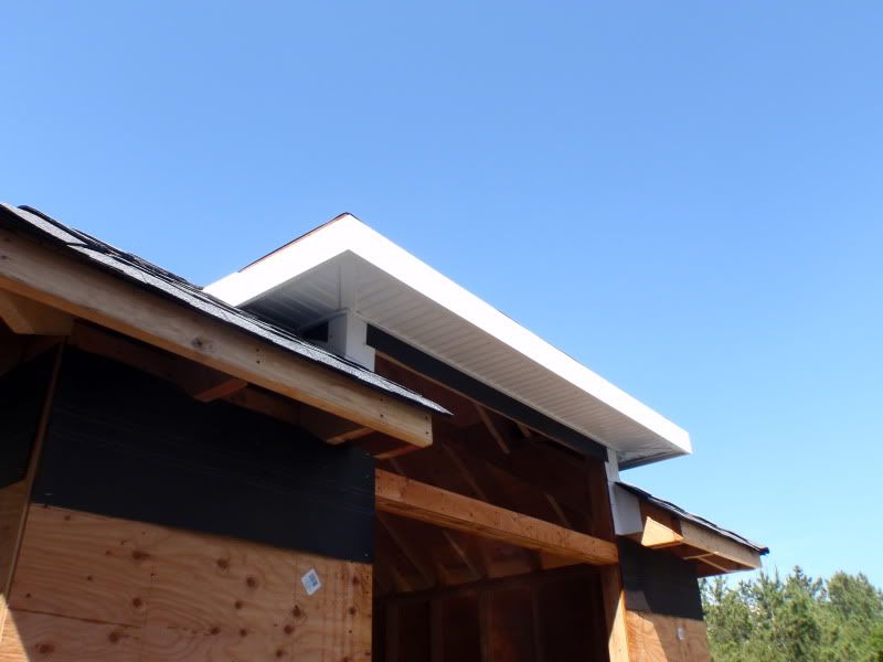

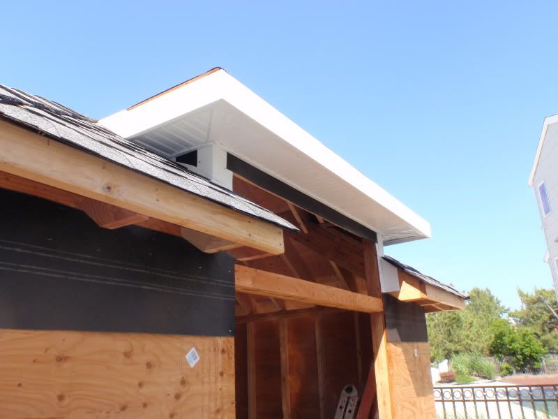

Translation?Good eye, being the inside ceiling is getting flattened and the valley rafter was so close to the hip I am going to do an over frame by cutting a 2x4 on a 8 1/2 pitch and lay it ontop of the smaller front dormers rafters and sheath over it.... other wise my valley rafters would have only been about 3 inches.
