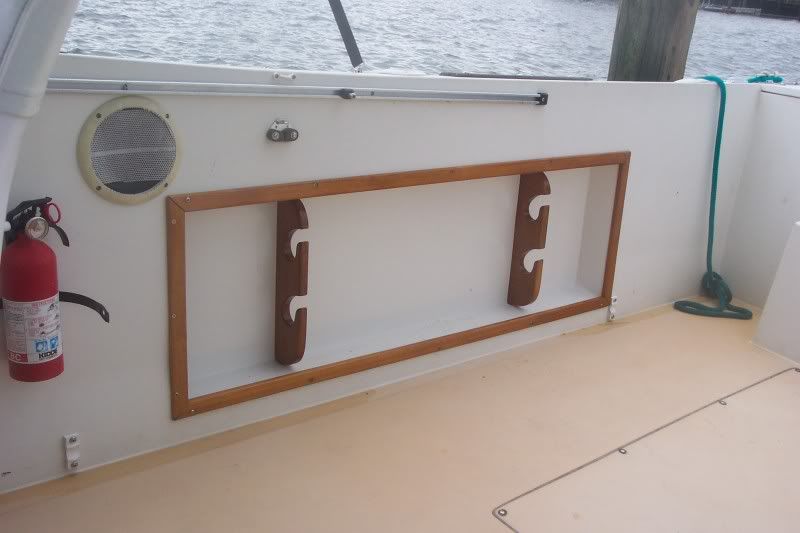

This is the result of the repair and refinishing of the rod boxes. Both the port and starboard rod boxes were cracked and broken so I reinforced the back sides with 6 OZ fiberglass cloth and epoxy resin. I sprayed the front sides of the boxes with Interlux Brightsides off-white polyurethane which matched the gel coat pretty well. The original color of the boxes was the brownish orange floor color.
I still have some teak to refinish at the helm and the cabin hatch deck slides.

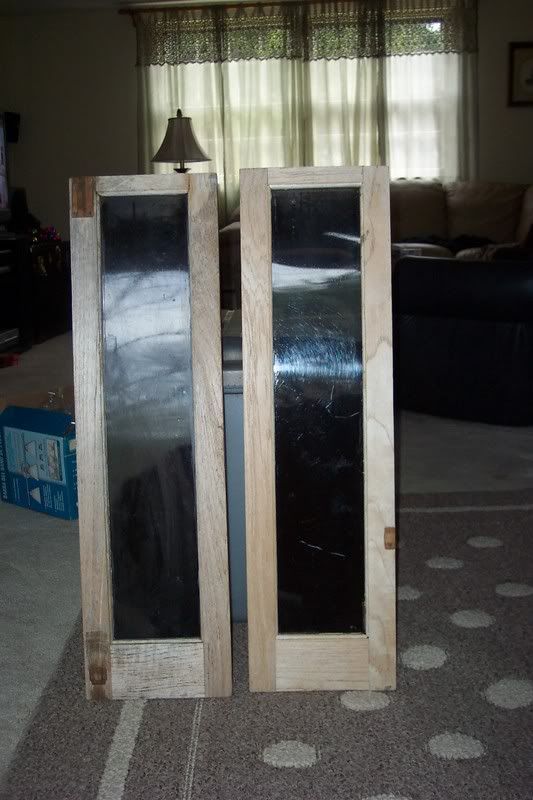

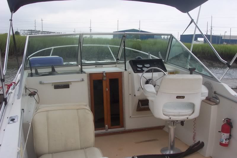

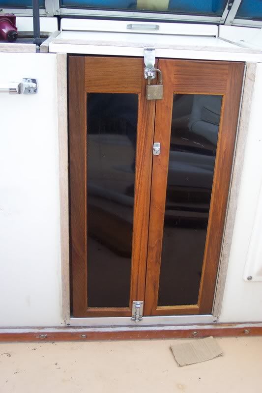

The cabin door was coming apart at the glue joints. I re-glued them using Titebond 3 which is totally waterproof. I was going to re-glue them using Gorilla glue, but decided against it because gorilla glue foams and doesn't take finish well without alot of sanding. The finish I used on the teak is Sikkens Cetol Natural Teak. Actually the cabin door was the first repair refinish job I did and the finished door was done 3 years ago with no current signs of deterioration!!

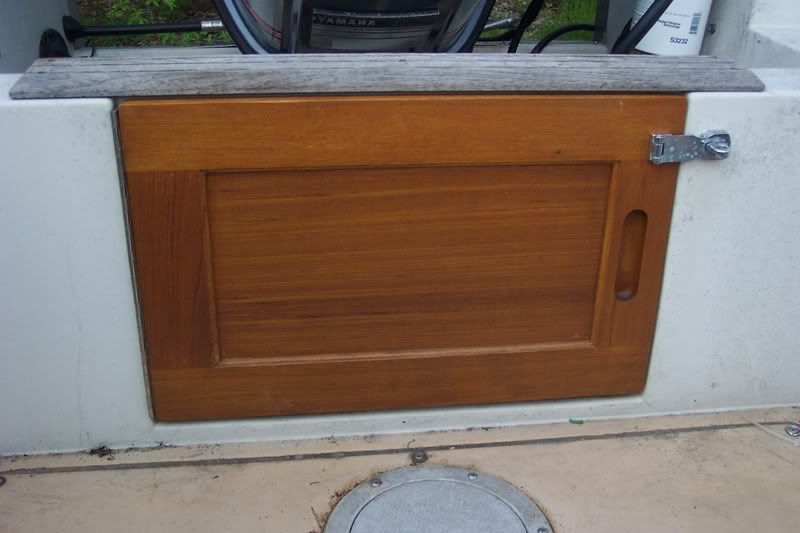

This is the bilge door in the stern. When I got the V20 the center of the door was delaminating so I replaced the center with a piece of marine teak plywood I got from a marine wood supplier in Marathon Florida. Dont ask what it cost!!
This is the cabin door after gluing and before refinishing.
