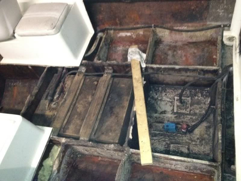

the stringes and transom are dust, literally. no need to drill any holes. the po installed a hatch in the deck just forward of the console and lined it with aluminium. not a good idea or a good job. i suspect that caused the rot.

Best way- Cap off, flip it and fix it. Then you also have access to stringers and transom.
The other way is cut the deck out, flip & fix, patch it back in. Easier removal & handling than cap off but not as clean end result. No access to inside transom either.
Both of these ways save the original skin of the deck.
Some guys have trashed the deck and made a new one entirely. Then you have to glass a new skin and make hatches yourself.

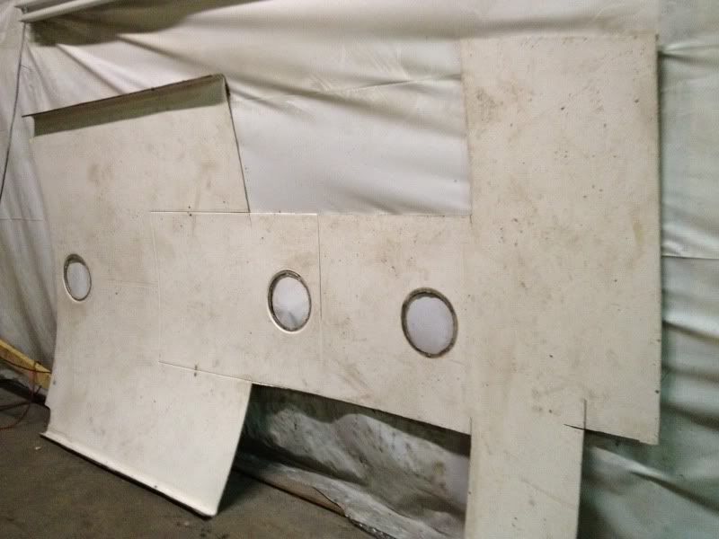

I'm sure that others besides me have redone their floor, but here's what I did. The story: The previous owner never vented under the floor, especially in the winter months with the boat covered.. so the floor rotted out but the stringers were still fine. Thank God he sold the boat to me before they did. The fix: Cut out the floor leaving a 2" border around the seats and in from the hull at the transom. Take out the floor, turn it over, pry, scrape, remove and clean all of the rotted wood off the underside of the floor. Then glue (Liquid Nails or equivalent) and Stainless screw irregular pieces of plywood to the underside. (Use irregular pieces so they don't make a continuous joint line like a box shape would). Then SEAL (something Wellcraft never did) the wood. I used fiberglass, but I don't see why you couldn't just use a good brand of wood sealer or epoxy. (Note: I had to remove all the old foam in the voids as it was waterlogged). Then I made a shelf out of scrap plywood and glued and screwed it to the underside of the 2" border that I left when I cut out the deck. Foamed the voids over the top so they would meet the bottom of my new deck. (Let the stringers be your guide for that part, and you'll have to cut and scrape the foam to properly shape it before you put your deck back onto it. But it's soft, and, while messy, it goes pretty quickly). Then I put the floor back onto the shelf, with glue and screws, and finally I covered the entire deck in U-Pol Raptor Truck bed liner (like Rhinoliner). I used the liner material because it's tough, has a nice soft rubbery feel to it on bare feet, is a great non-skid, cleans up easily and, because of it's thickness when applying, it filled all the joint lines and screw heads, making them completely invisible.
So your comment about filling the voids to the bottom of the deck is valid. I did it and my deck is solid as a rock.

No, under the floor is wood between glass. Actually, lots of little plywood squares. You can find some pix here if you look around. What you want to do is save the outside deck skin and fix from the bottom.
If you take the cap off and flip it (easily said...) you can cut out bad wood from bottom. The cap is "glued" with a poly resin filler/adhesive. Much of it has probably already broken loose and is probably blocking the drains in the bilge.
Make sure your repair is not thicker than original because the cap has to fit when it goes back on.
