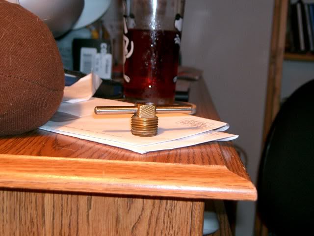

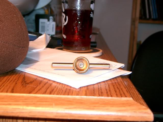

here's his
2ndchance said:
Hey Stink, great idea, here is my version of the plug. Tool Maker Style
I used a .250 X 3" CRES dowel pin. I set up my plug and drilled and reamed the hole to .249 to get a .0005 to the side press fit.
Then just for insurance I drilled and tapped a 1/4-20 hole from the inside and installed a CRES set screw.
