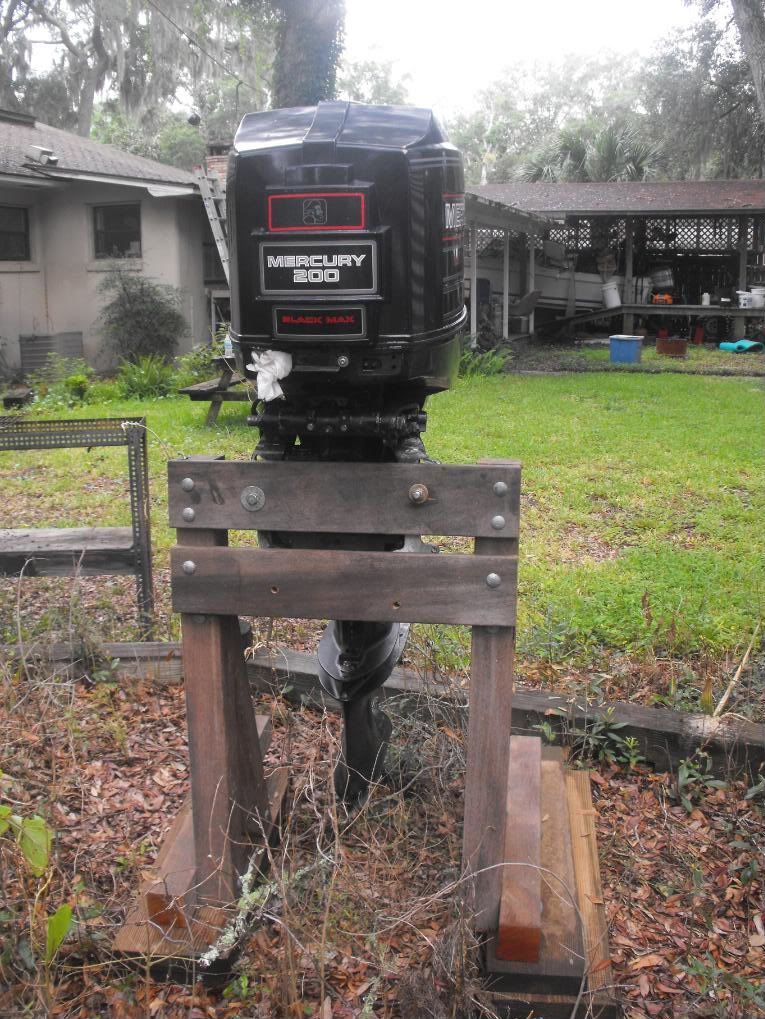

stink, i 've got a 200 on a stand in the back yard you could field test for me...
A 200 on an 18 WELLCRAFT should flat out HAUL A$$. I bet the chine walk would give you one heck of a pucker factor at speed. Not to mention how fast them 200 2.5 MERC's respond. I still think a regular 2.0L 150 would be ideal, and be good on fuel.
