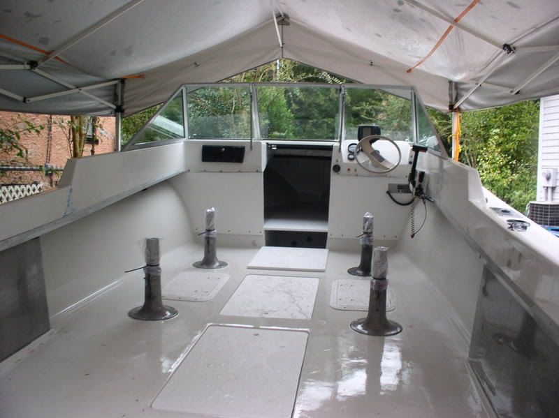

I have been contemplating replacing the teak floor hatch covers with starboard. I noticed Reel & MJ have/had the starboard hatch covers and I do like how they look. However my question is, do you have to add some sort of support underneath the cover so it won't bend when being stepped on? I know I pack some pounds and was wondering if the material will hold up when my fat arse steps on it. So I was wondering if some cleats underneath would add support and if so how do you attach them?
Thanks for any help guys.
Use 3/4.
No need for any more support.

Tsubaki,
Thanks for the info and I always appreciate your ("make my life easier") mods. I love your "bilge guard" too, that's a great idea! I plan on doing the floor with the light grey Durabak so im going for the whole new clean look routine. I will make sure to take lots of pictures of my progress and the end results. Hopefully if the weather holds out for this weekend I may be laying down the first coat of paint. Pictures coming soon.

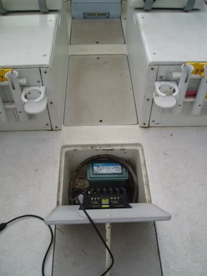

Tsubaki's right about using 3/4"...I'm no lightweight and have had some healthy lads aboard w/no probs...keep in mind Starboard in this size WILL expand, so leave some "wiggle room"...I chose light grey and it gets hot on bare feet in summer's direct sun...white will not. They make it now w/diamond texture and I think I would use it now in this application
The aft lid is split w/the onboard charger attached under the front half, folds up for charging...on the bottom of the hatch in back are two group 31 batteries for the electric trolling motor...the two lid pieces are connected w/a SS continuous hinge. 3/4" finger holes in each end of each lid make lifting hardware unneccessary and work like a champ.:beer:

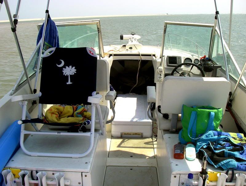

One thing I did that really worked out well was find a 120 qt cooler that fit like a glove in the forward hatch, then cut a piece of Starboard to cover the remaining opening, curving the front edges to wrap the cooler...cooler is my fish-box/storage depending on need...
