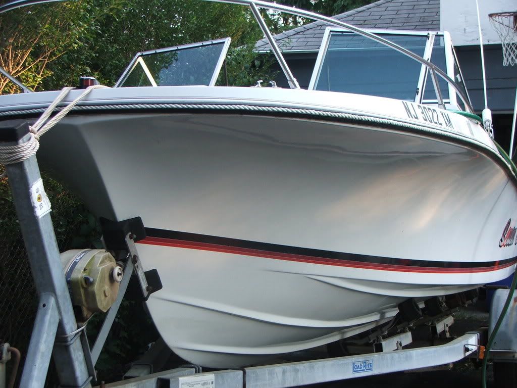

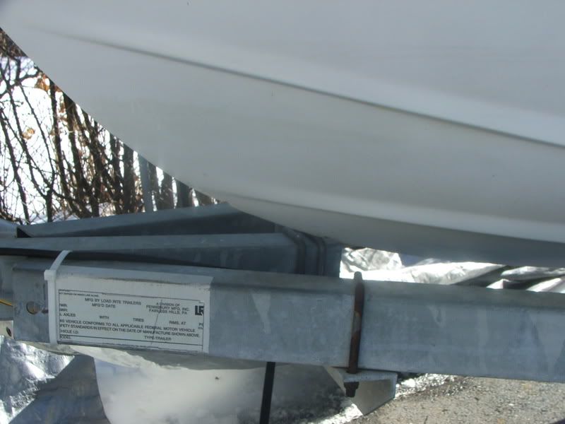

As some of you guys pointed out my boat sits pretty bow down when its on my trailer. What concerns me the most is how close the keel comes to the end of the tongue on the trailer. It literally rests on it and there is more than one chip in the fiberglass around that area.

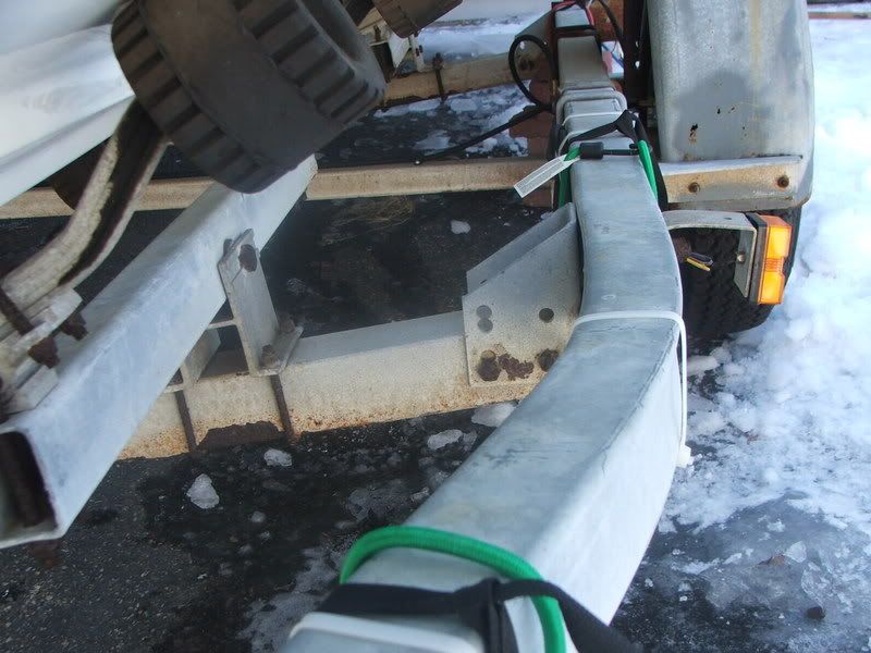

As you can see the front cross support that holds the first set of rollers is set at its lowest position. I am considereing moving it up but but its been this way for 23 years and I am wondering if maybe they new something I didnt when they set it up this way.
Maybe the keel will hit the cross support before it catches the rollers?Maybe I wont be able to adjust the bow support properly and it will interfere with the the bow eye?
Anybody got any experience in adjusting these things.?

In your 3rd pic; you could cut off (shorten) the center stringer (where the bow almost hits now) closer to the winch area and still be able to attach the cross brace to the outside frame rails. If you cut about 3" forward of the U bolts looks like that would give you plenty of clearance.
Those tongue ends are made to fit various length trailers so they could be shortened to fit your boat needs.

Looks to me that the whole trailer is just to short? The rear rollers should be right at the transom, yours looks to short and the boat over hangs. This is why the bow is so far foward and hitting.
Short of getting a different trailer the cutting of the tounge is about all you can do.
Or you can get a bolt on roller (a wide one) and add it to the tounge so that when the bow gets there it will go on a roller and lift a bit.
Good Luck
your trailer is to short for that boat you need the transom supported or it will cause stress and cracks in the transom.

looks to me in the 3rd pic,you mite be able, to relocate the front cross bar to the upper bolt holes an giving you the clearence you need to make the other adjustments needed
That was my original solution off the top of my head. My working solution at the moment is raise the front cross support, add a keel roller and move the bow support toward the hitch to get the boat further forward and support the transom better.

4. As a last resort I would raise the front crossmember to the next notch but I don't recall seeing one that way.
