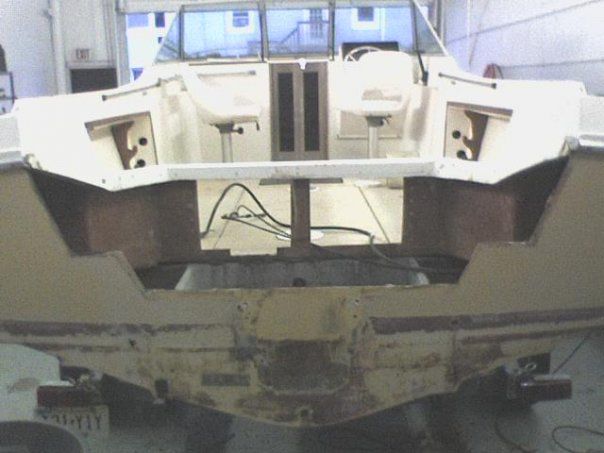

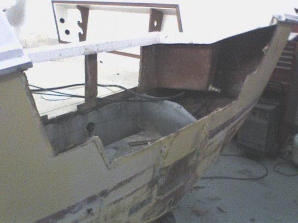

Finally started cutting into it today. I got the cap off and I'm getting ready to cut the floor.

Floor is out. Stringers look good but transom is mush, comes out nice and easy so far. Need to make a little dust tomorrow to get the edges out.
