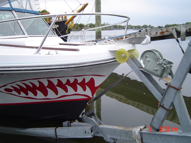

Hammer, in that pic you have the boat in way, way to deep. The stern has floated up, lowering the bow. When I launch I have the tires in about 6" of water, the let her (controlled) roll off, won't have any problems at all. That's where you ran into problems.
