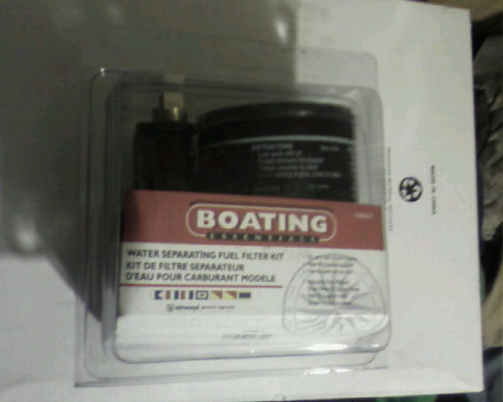

I bought this fuel filter and bracket from Wal-mart for $27.00. Is it any good? If so i'll get another. I'll be using them on 1986 Yamaha 150's.
You will be fine!!
Just remember that you need to take it off every few trips and drain, to make sure you have no water in it. Its not self draining so it only hold a small amout of water then its doing nothing!
Drain into a clear container and look at it after awhile to see water seprate from the gas. This will tell you if you have been getting any.
Same one I use for my 170 Mercruiser. Seems ta work OK for me. I would take it off and dump it like MJ said, just to check it out so as not to get water in your system.
