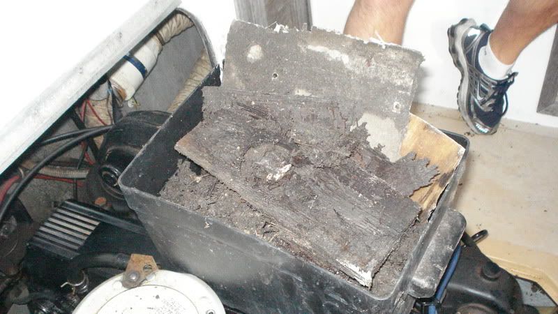

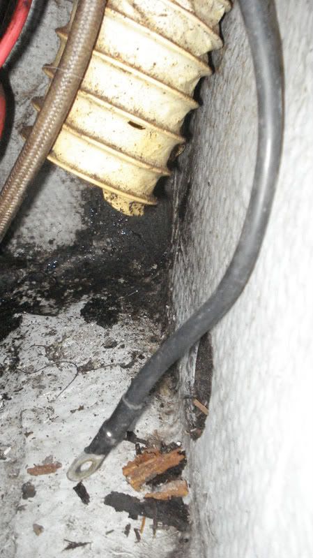

I have an I/O for those of you who dont know and I was going to put the new battery in yesterday (i replace one every year). So i take the old one out and put the new one in, and it fell through the floor. I am not sure what the battery location looks like on an OB. but on an I/O these is a small platform on each side for it to sit on. So after a little digging, I come to find that the plywood under the fiberglass is now TOPSOIL. and that is no exaggeration. I mean TOPSOIL. I/O's are made to drain the deck through the rear deck drains across the battery platform and then through a hole down into the bilge. well I guess 24 years is too much for the battery platform to be able to take on water. So I RIPPED all of it out. and need to build a new battery platform for each side. Any suggestions I was going to use Starboard. I have pictures and will post them at lunch today. Forgot to bring the camera to work.

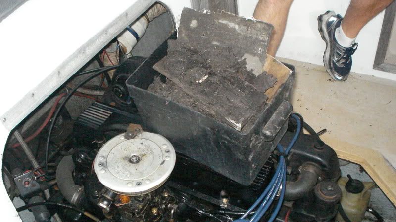

so here is the pic of what it looked like when i took the battery out. you can see the drain from the deck on the right. water runs out there and works it way around the battery and down the side of the platform to a hole that leads to the bilge. (last pic)

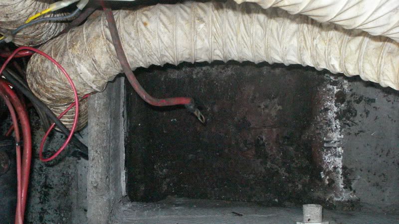

and here it is after i cut out the fiberglass

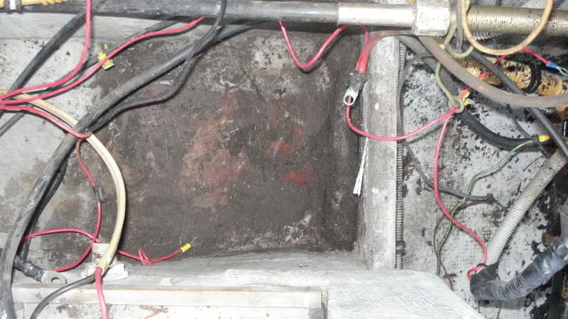

here is the other side all torn out

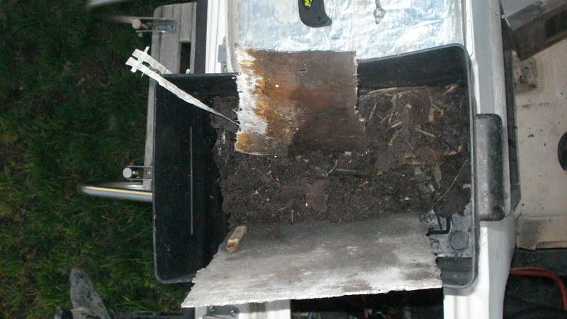

and here is what came out of it.
filled the battery box full of what used to be plywood

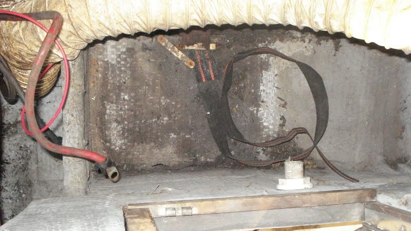

and here is the hole under the motor where the water is supposed to drain out from under the battery box. the wall on the right is the battery box. the bottom of the bilge is too the left.
I second Stillrunning, wood or plywood, well soaked with F.G.resin, will last a long time.

gonna price some starboard tonight and if too much money i will due it out of pressure treated plywood.:head:

not enough room for both batteries on one side. and both sides were rotten and torn out. I made a platform last night out of a couple pieces of a treated 4x4 and a piece of 1/2 inch plywood. i took some pics and will post at lunch. thanks for your advice.:beer:
oh, and I put a hose on the drain and tried to run it to the bilge, but it is pinching itself off due to the routing method i had to take, so I will have to cut some holes in my new platform after this weekend.:head:
