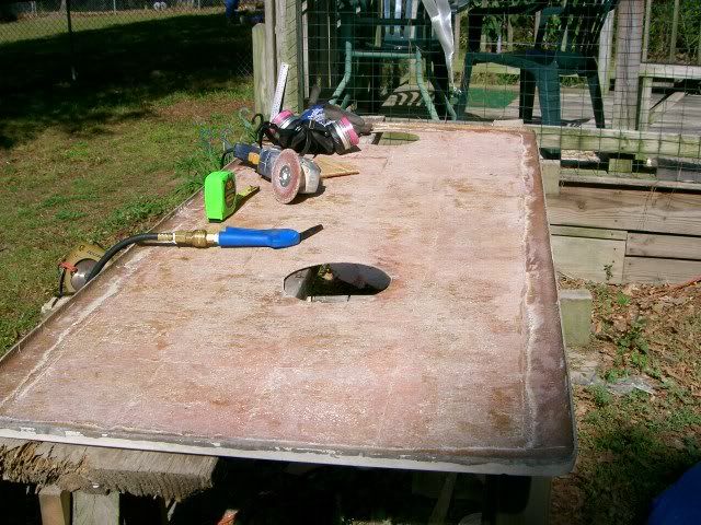

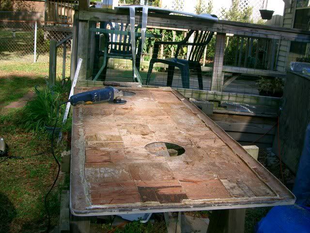

Now you tell me ;). After I spent another C note on West System Epoxy for my fuel tank cover. Oh well its only money and the fuel tank cover does need to be strong. Here are some pics of the fuel tank cover being repaired. First I had to grind off what was left of the 48 plywood sqaures
After grinding pic

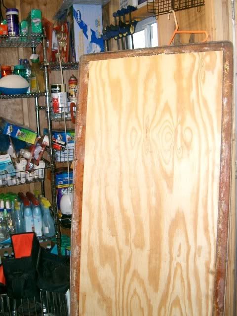

After a blowing off and a wipe down with acetone I mixed the West sys. epoxy and added the stuff to make a paste. Then I laid it out on my shed floor and spread the epoxy out and laid a solid peice of plywood down on it with 4 cinder blocks on top for weight. Aint no way I'm using 48 little sqaures of plywood.
I'm going to let it cure over night and then glass the inside.
