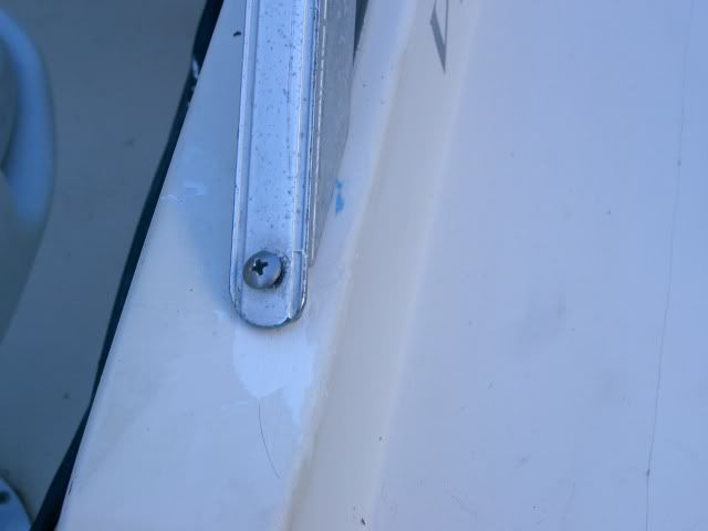

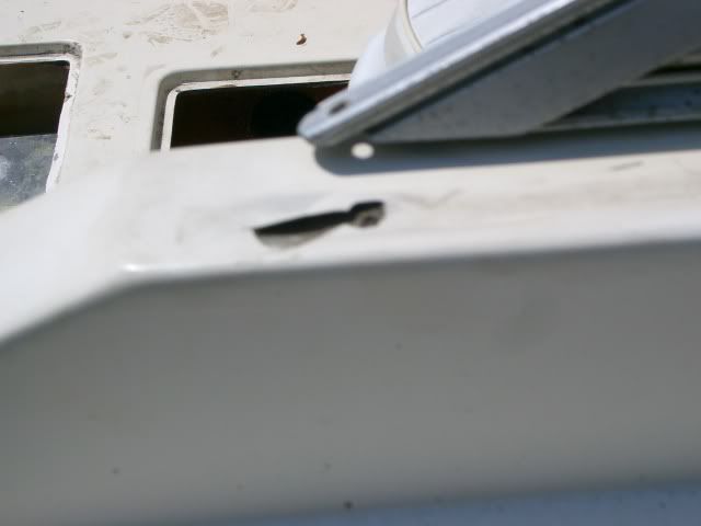

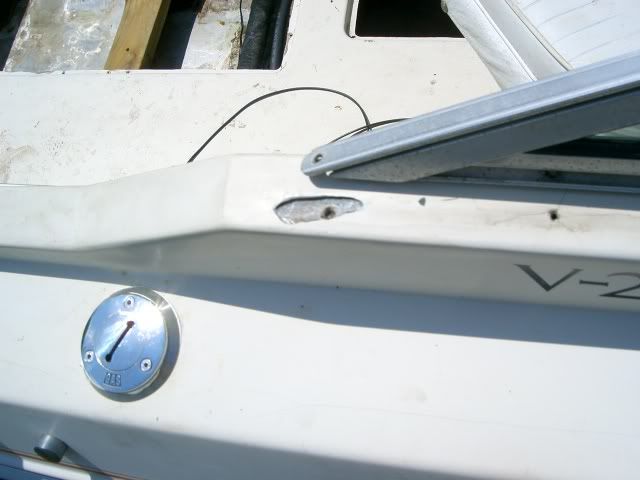

I finally got around to repairing the starboard windsheild. I took a few pics for the picture hounds.
After removing the screws, notice the chunk of Gel coat that is missing and the void that was under it.
The area after prepping.
I didn't take any pics of mixing the Marine Tex and fairing the repair area in. Here is the finished project. I also put Marine Tex in all of the screw holes and I used 5200 on all of the screws.
