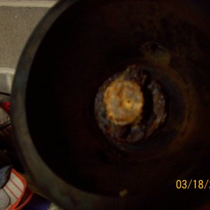

Punching out remainder of roll pin.

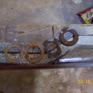

Old plastic and steel washers. Maybe I should reuse them, NOT!

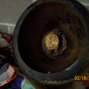

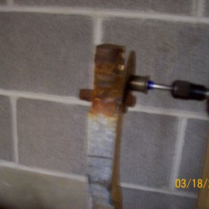

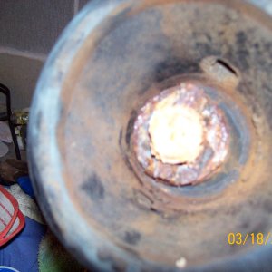

Cutting off inner roll pin.

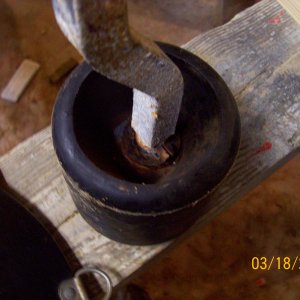

Outter roll pin and roller removed

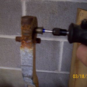

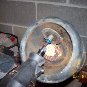

Dremel with cut off wheel works great here.

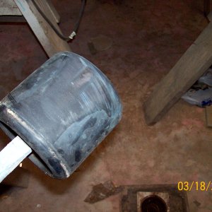

Wear marks from boat sliding onto and off the trailer.
This roller was completely froze in place. What a drag unloading the boat.

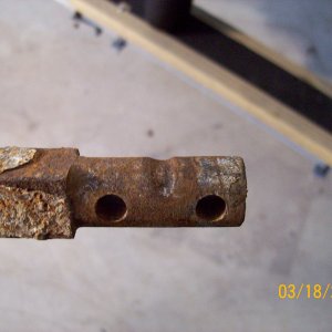

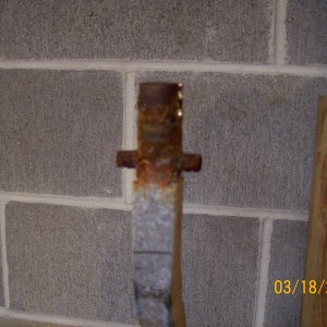

Grove cut into roller arm.

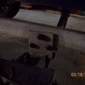

More rusted bolts to replace.

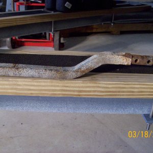

Rollers removed.
Rollers removed.

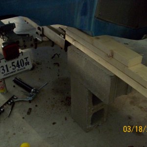

Stern supported to replace rollers.

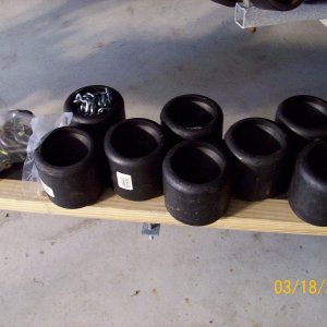

New rollers, hog rings and square bend bolts.

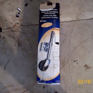

New jack to replace old one. Lube on old one did not help much

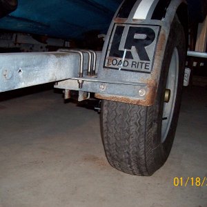

Stainless bolts holding wheel wells

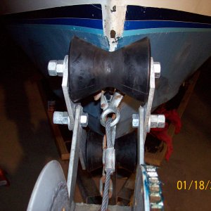

Wider bow roller allows easier cable and safety chain hook up.
