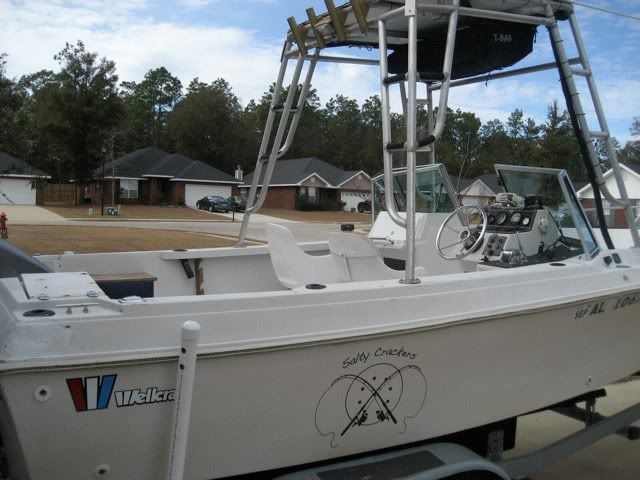

Here is a quick pick from a few weeks ao....since then I have removed the hard top....replaced with canvas....made a new starboard side stern hatch cover out of starboard....and removed the teak rod holders and started refinishing them.....I will try to remember to take a few pictures and post soon
