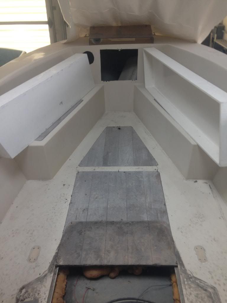

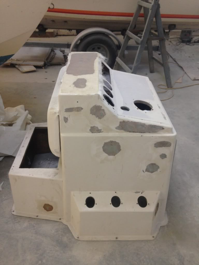

Got the boat a few years ago and now I've got time and shop to begin repairs. This year It's getting a new transom, new aft bulkhead, leaning post, engine, complete rigging, hydraulic steering, electronics, fill 42 holes in console and spray, get rid of wood panel over gas tank and glass over and install inspection plates, replace all teak trim and anchor locker door. There's probably more but that's def enough to get done by striper spring run.
Next year, re-core deck and modify console and maybe install windlass.

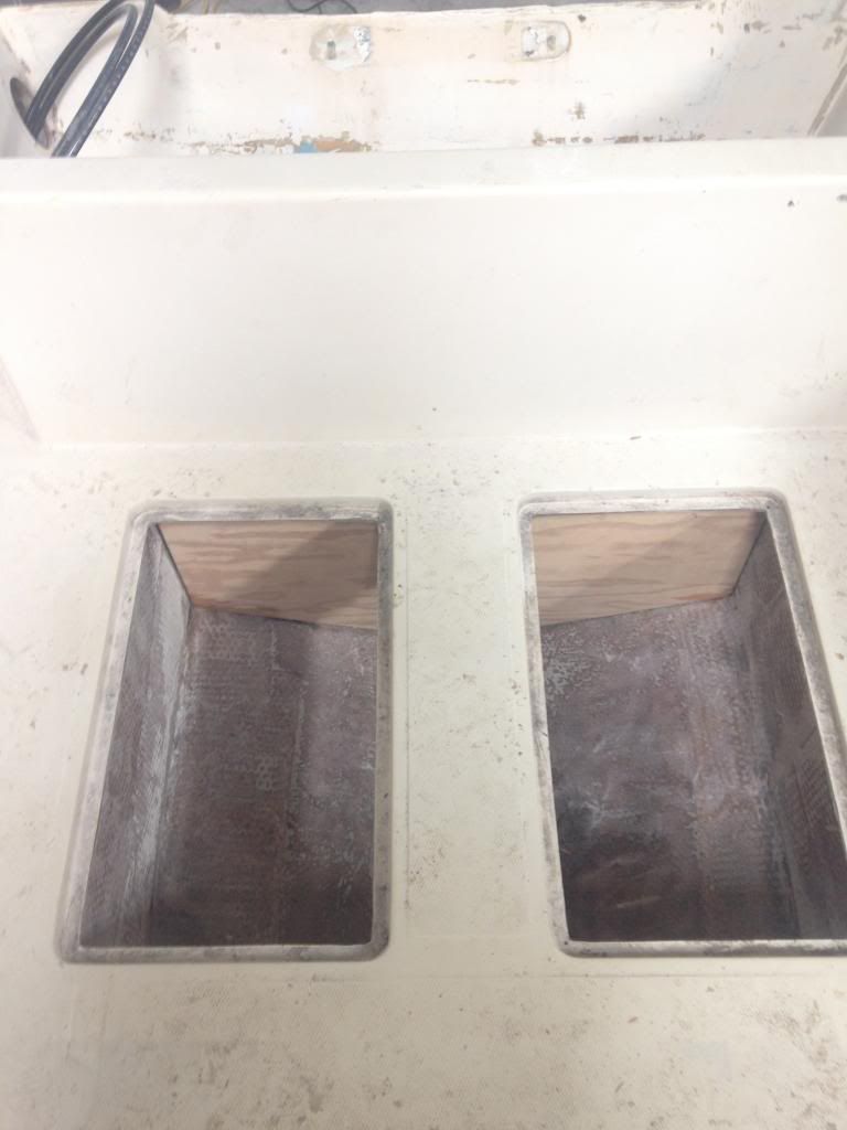

Only comment I would make is that I had the floor Livewell in my CC and hated it! Splashed out when the door was open and closed. I ended up hangin new livewells on the transom(closed) and it worked wonderfully. There's a million different setups but I hated the in-deck one the most. Plus if you're like me you go through alot of bait. Who wants to be up and down off the floor all day????
Yeah, I'm thinking of either cutting off the well on mine and just having some extra bilge access or insulating it better and making it into a cooler/storage. I will be going with the leaning post livewell. Since I am going the bracket route I want to get as much weight away from the transom anyways.
I hear you about kneeling to get bait.
Insulating is a great idea although most days I reach for a beer more than bait.
I'm also putting a leaning post and I can fit a livewell there and use the space under the deck for cooler that may work out good. That bulkhead I'm installing is going to seal that compartment. Then extending pvc pipe drain from fwd box to aft bilge. Then install a fitting to a mascerator to pump out the compartment.
Or- I could seal the compartment, keep the drain from fwd box and use mascerator to empty both, then put a plug or valve to close off fwd box when I don't want it to drain.

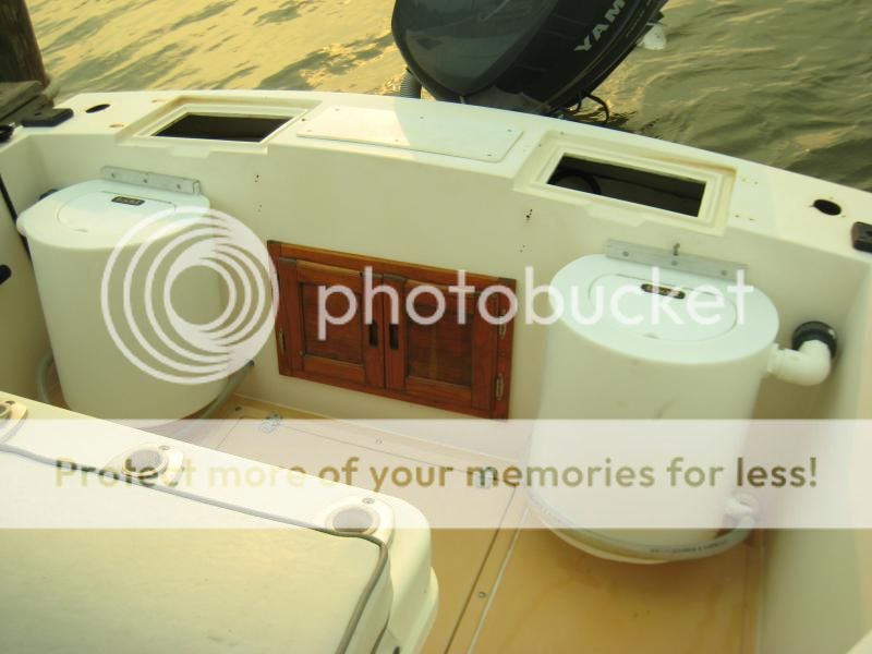

Here is my livewell solution. Cut the bottom outta the old one and kept the hatch. I keep all my pumps under there now.....Cant tell you how nice it is to have your own livewell in the corner. Keeps everyone from bum-rushin the center of the boat for bait......

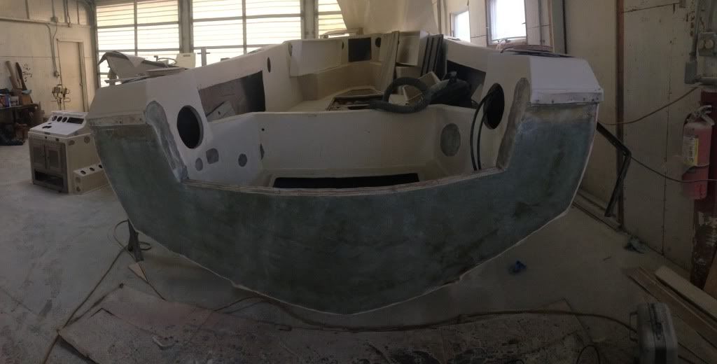

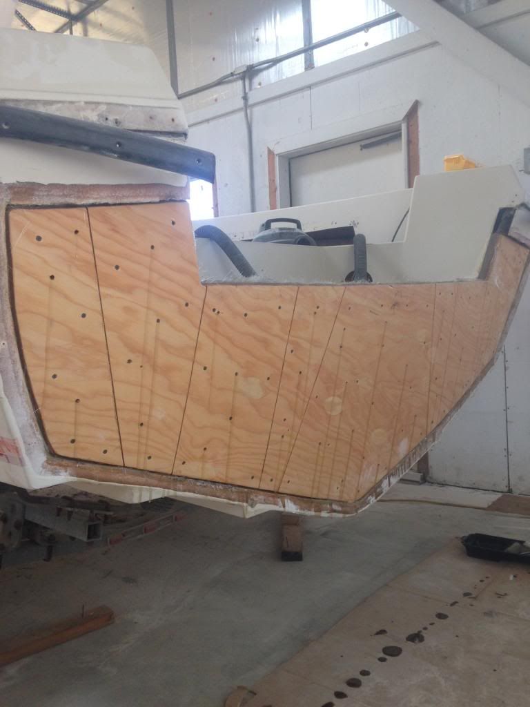

Been making progress slowly but surely. Getting in the shop between everything else going on. I've put 9 layers of 1708 biaxial and will be putting 2 layers of mat on the outer transom. Been patching unneeded holes and stress cracks with leftover material. I'm hoping to spray gelcoat by the end of next week.:beer:
