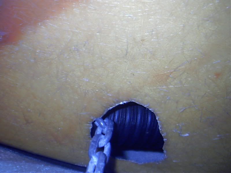

Boatnluvr, this is what i did about the open hole from a capless deck pipe. i needed an extra large opening for the amount of chain i have(30' for diving). it is a piece of 4" drain tile that is between the deck and ths shelf in the cabin. it carries the water into the anchor locker and to the bilge.
top shot of pulpit
inside shot of drain tile

So what hold the black tubing to the underside of teh bow. Ok, lets define anchor locker guys. I presume you are talking about that little cut out area inside the cuddy were your bow eye/cleat is mounted ?
I always wondered if that was enough room for 150 feet of rope. Or do you store your rope where the cut out storage area is where some guys put a porta potty ?? Phats, the black tubing, does that go through the cuddy shelf and straight into that locker ? I really like that Idea. You able to get a better distant shot of your set up. Your giving me more diving ideas.

The deck pipe has screws sticking into the cabin about 1.5" the drain tile goes around then and is compressed to fit. there is a 3" hole in the shelf. on mine (83) the top locker feeds into the locker under the bunks in the cuddy. i carry about 250' 1/2 anchor line(rode to you nautical wheelers) with 30 ft of chain. i hate coming back and the anchor has been dragging.

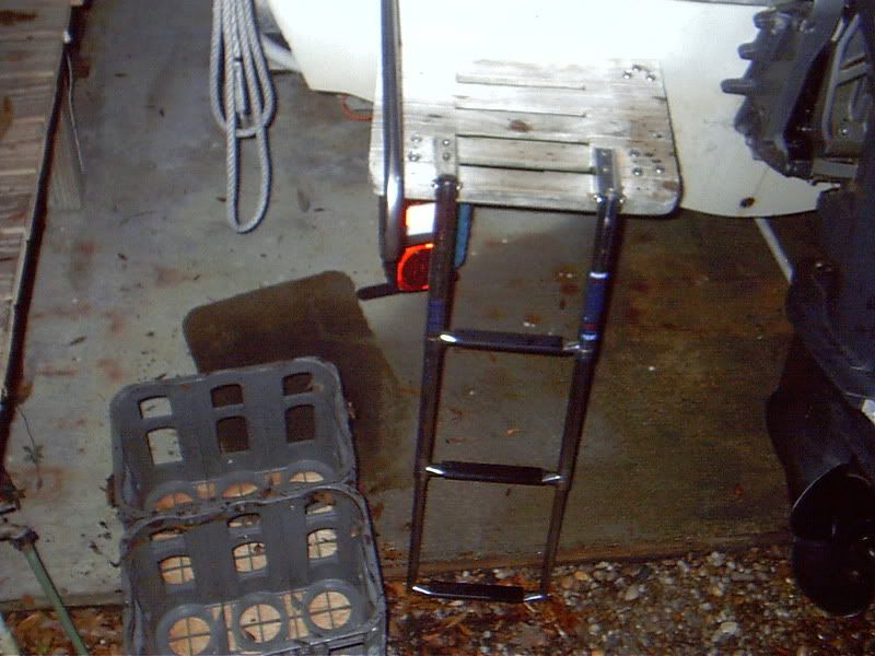

this is a 3 step ladder that helps a lot that is a tank rack i made out of 2 two liter coke crates on plywood with a piece of rubber on the bottom. works greeat and holds 4 tanks with bc's
this is a tank holder system that holds a 80 cf tank upright. i have four of them onboard

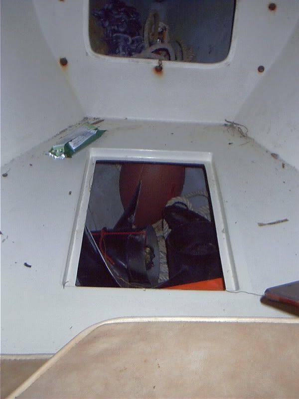

shots of the anchor lockers
inside of the connecting tube
That last pic got me all confused?? were is that hole cut?

mj that is a shot of inside the anchor locker looking up to the shelf above.
i dived off of a couple of boats with a bracket and it is great. like having a big ole back porch on you boat. the only thing you have to be careful of is anything you set down on the bracket will be washed off. set your gear in the boat not on the bracket.
My boat doesn't have that shelf, Like yours I have the opening in the cuddy, But the liner just stops at that opening allowing the rope to go all the way down.
Thats why my chain keeps getting jamed between the liner and the hull. I have to do something to stop that??
