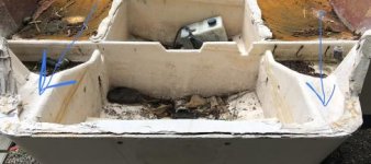

Sounds like you have a well thought out plan in place. Just a slight piece of advice. Look carefully at the inside of the transom where the set back "bubble" it comes through the transom. See that 1" gap on either side? My advice is to fill it and then glass over it to either side of the stringers back there for much needed and added strength. The general consensus of thought is that the reason these hulls are only rated for 200 HP outboards is that the original construction of the way the bubble is attached through the transom made it unwise to rate the hull for a higher HP engine. Just my 2 cents, but that's what I did with my 96 V21 when I had the deck off it.

Also what bubble are you referring to? I will try to snap a few pics of the transom and maybe you could point out to me what you mean.

I call the set back that the engine mounts onto the bubble. Don't know what else to call it so I coined the phrase. Since a V20 has an almost flat transom, the setback on the V21 from the outside looked like a bubble to me.
Anyways, if you look at the inside of the transom where the bubble is attached you'll see that the two pieces (transom and bubble) are not connected very well. There's a gap on the sides. it's that gap that I'm talking about. fill it with filler and then class it all together and that should add some additional strength to the whole transom. It's not necessary, but when I had my deck off and looked it just seemed prudent to do so.

Ok I think I see where you’re referring to. Right now there’s a layer of that hard filler on top of the transom but I hit it with a hammer on the sides and it feels like there is foam under it. Does seem like a very vurnable void. I’ll definitly look into it. I still haven’t confirmed the wood to be completely solid yet. If I grind/cut out the filler on top of the transom and the core seems wet I may be looking into a carbon-core pourable transom and it’d be ideal to seal the top of the transom up to the highest point where it meets the normal transom location and fill the lower transom and those voids at the same time. Very confusing I know haha. Hopefully in the next few days we’ll get some decent weather and I can get into it. Been raining nonstop here.

The gap I was talking about is inside your boat. if you stand inside and look at the stern where the bubble comes through the transom. Follow the stringers and there's a place where the vertical stringers go through the horizontal stringers + They could have been joined together for more strength but Wellcraft didn't do it. They left a gap between them of about an inch. That's the area I was talking about. Hard to tell from your pics if they did that on your hull but that was the case on mine.
