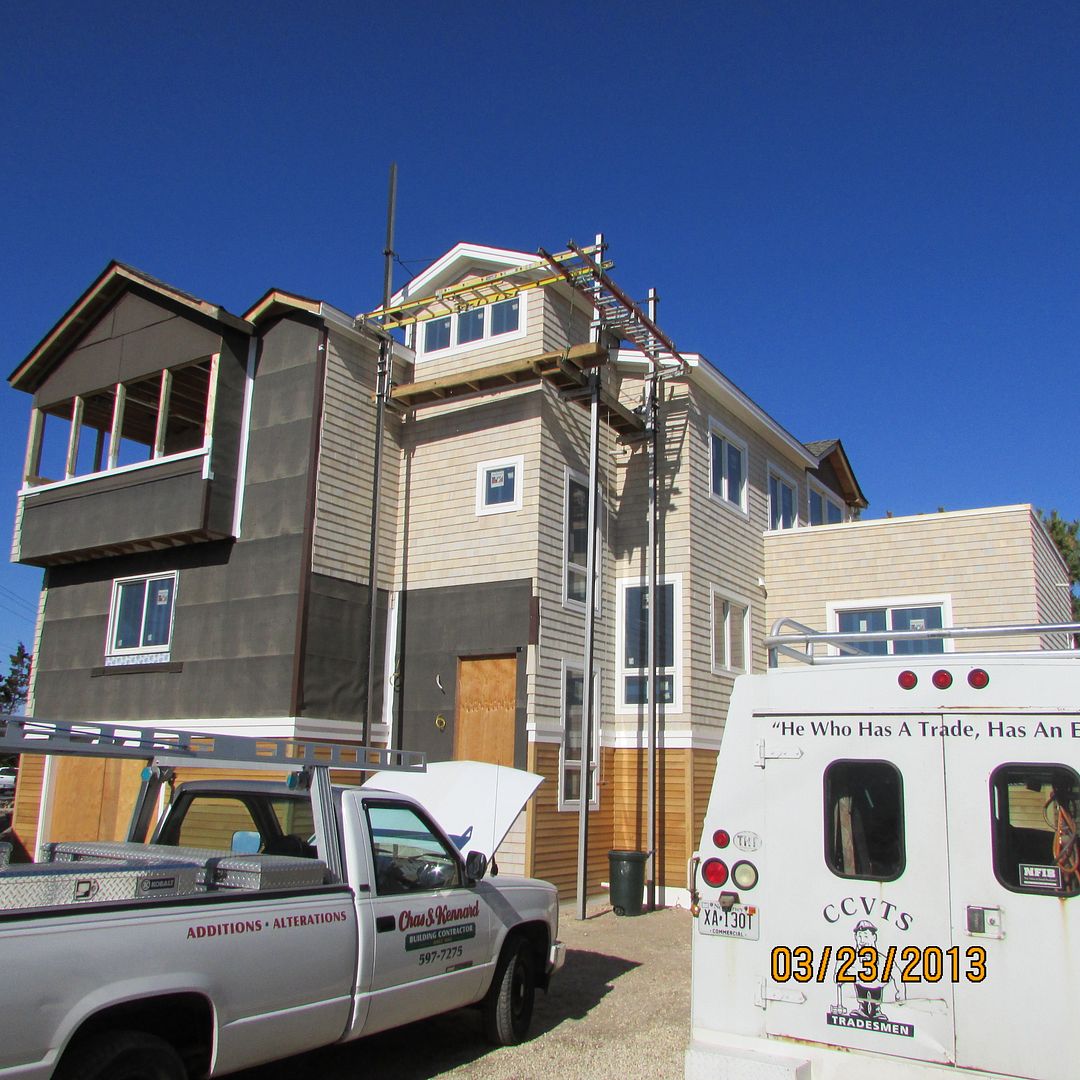

New project in Loveladies

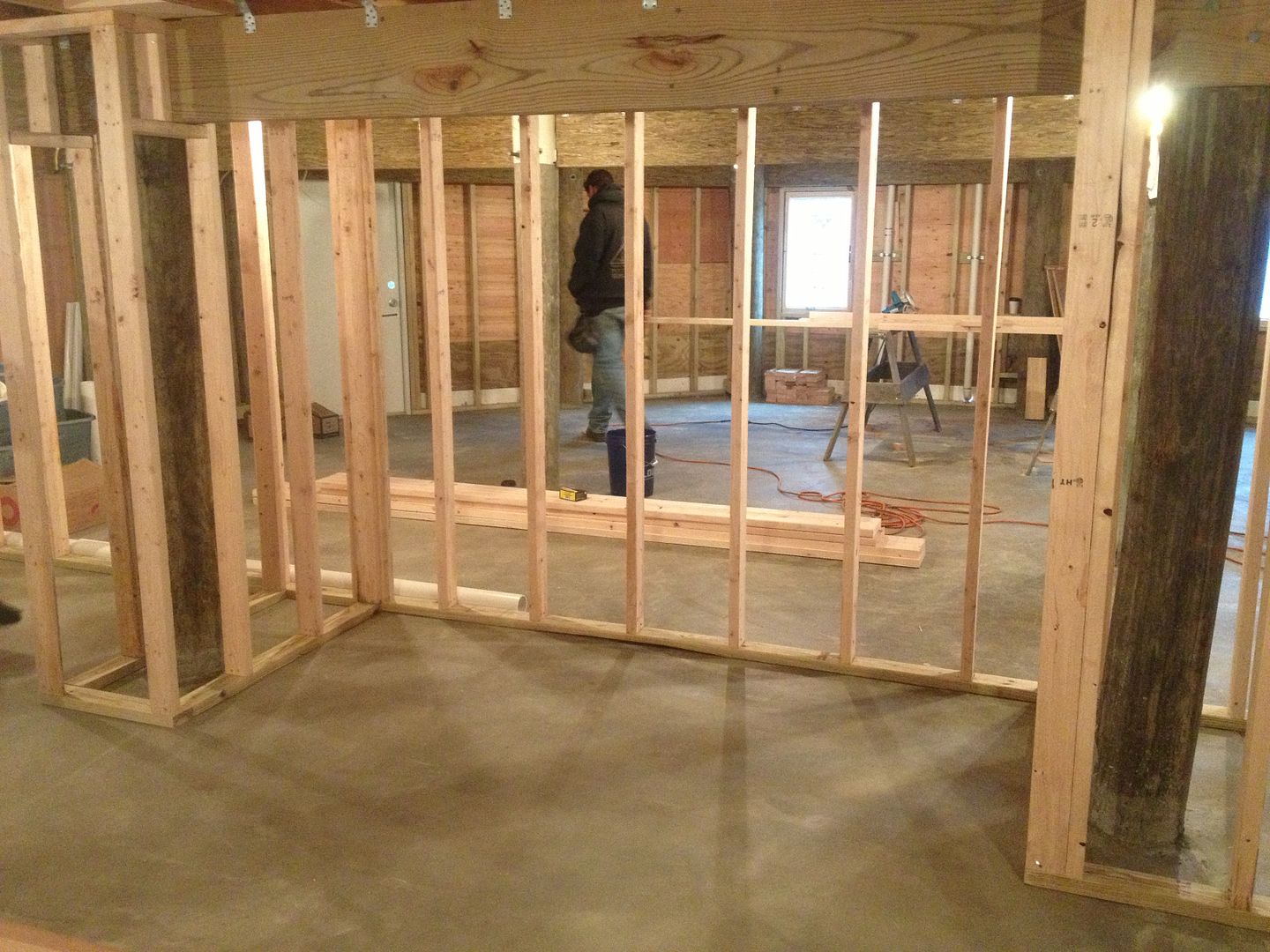

the garage level with a gaming room for the kids
looks like you and your crew take pride in your work, coming along great
That's putting it lightly... I can't think of a single contractor I've ever done work for who cares enough about what they're doing to a) take that many progess pics, b) keep a jobsight that clean and tight, and c) be so passionate to want to share it with everyone they know.
Congrats on the job. Looks like it's gonna turn out awesome.

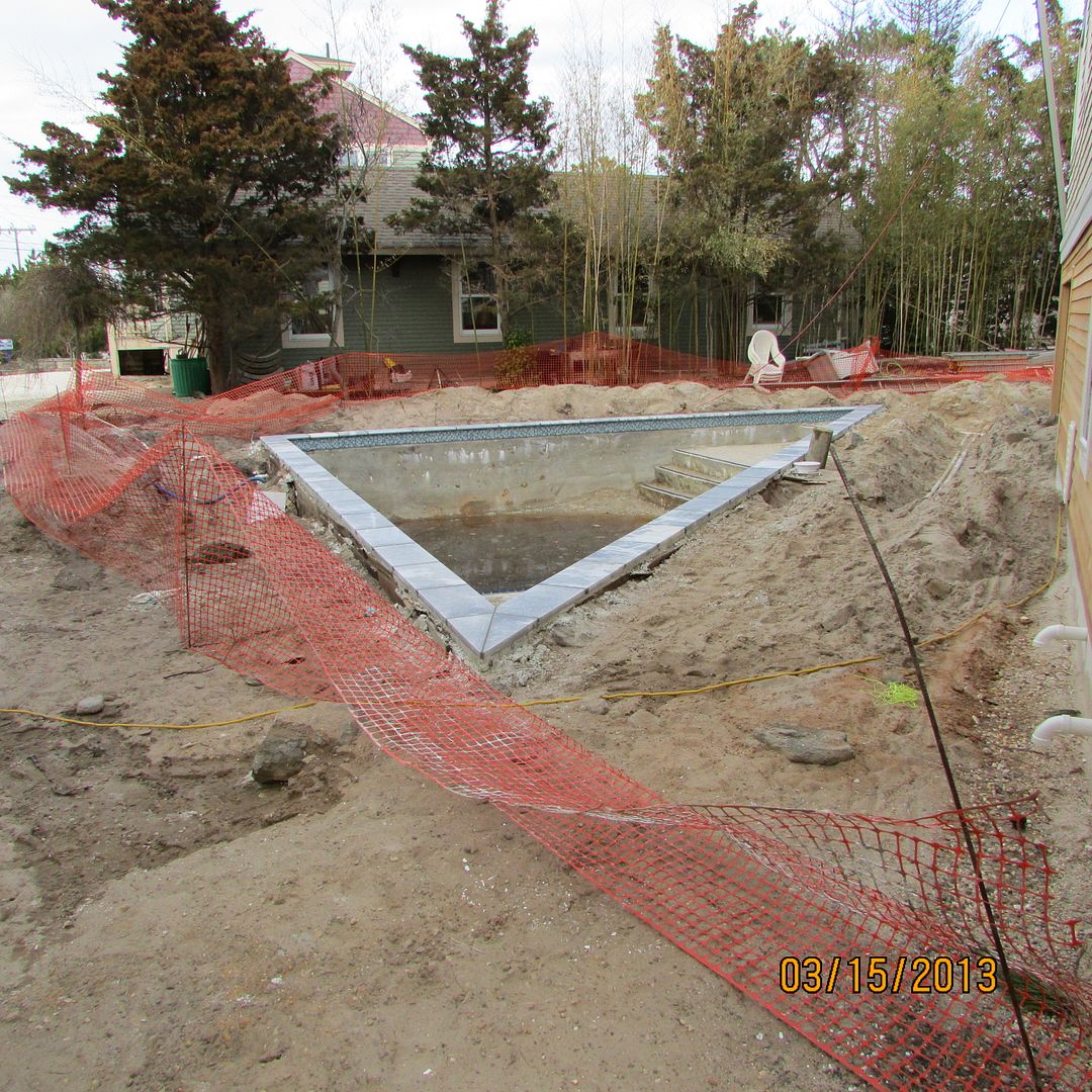

What supports the pilings? Do they just get hammered in like marine pilings or drilled in with an auger? Or is there some kind of footer beneath?
the pilings are 35 footers and are hammered in they hold good , and thanks for all the kind words we really do pride ourselves in quality and keeping the job site clean .... makes for a good attitude .

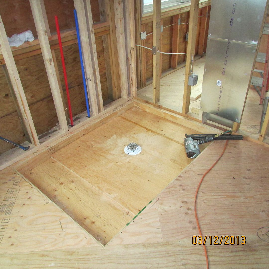

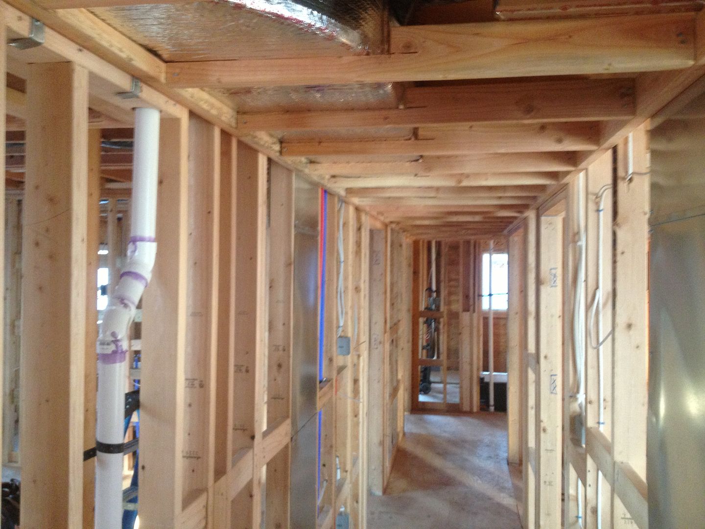

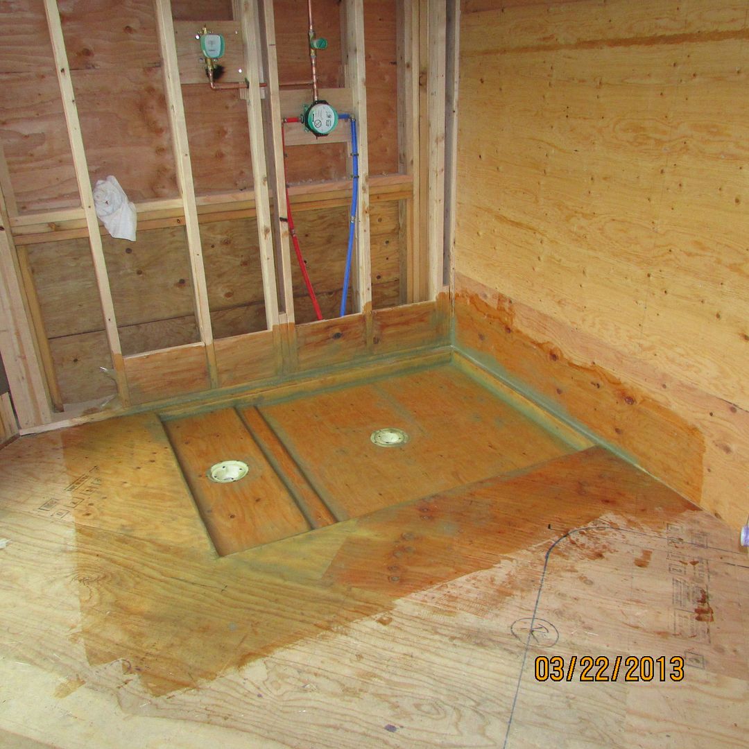

Question: In the very last pic, I take it that area is going to be a shower stall and a toilet? What is that spread on the floor and about a foot up the walls. Is it some kind of glue? ....and if so, why? Thanks
Beautiful work Lumber. You are indeed a skilled craftsman. :clap:

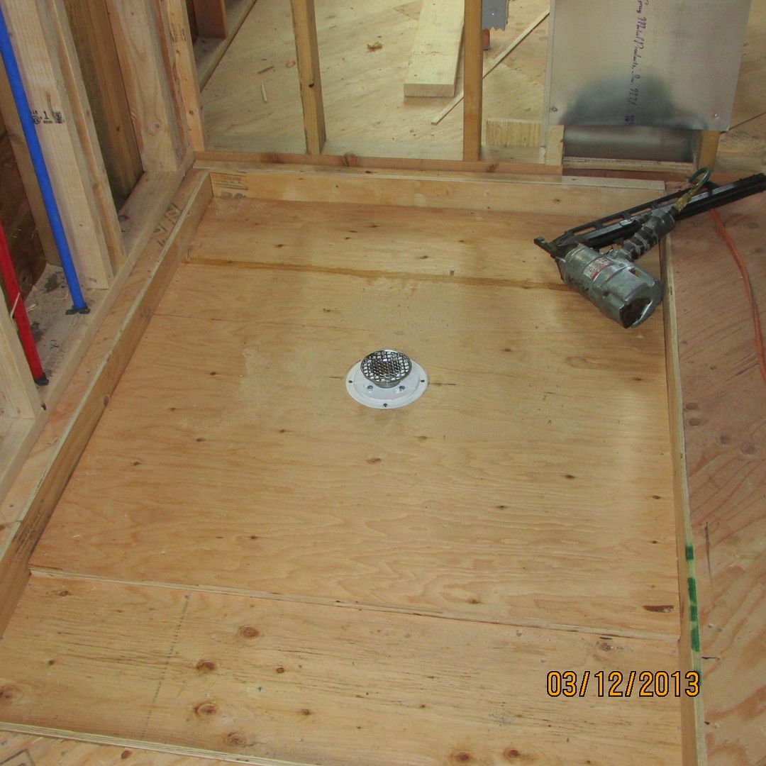

Thanks destroyer , thats fiberglass matt its going to be a walk in roman type shower the floor will be level with the rest of the bathroom with a clear glass wall with no door ... the drain to the right is the main drain and the other is a Long 4 inch x 42 inch what I call a micro drain .... kinda hard to explain but the owner came to me with an idea she had and asked me to make it work .. I will have pictures to follow .
Btw we fiberglass all our shower pans and laundry closets then the tile guys do mud pans ..... its way better than the old style rubber pans we used to use.
