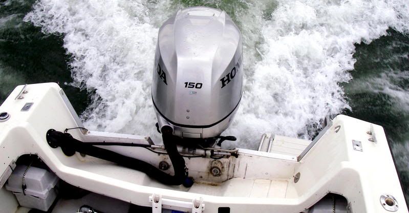

Hey Spare!!...one of us considered Honda on a repower
:hi:
those are a rare sight down here, I don't hear anything bad about them, just don't see that many, heard they had a new 90? that had the best power to weight ratio for any 4 stroke, i haven't seen one.
