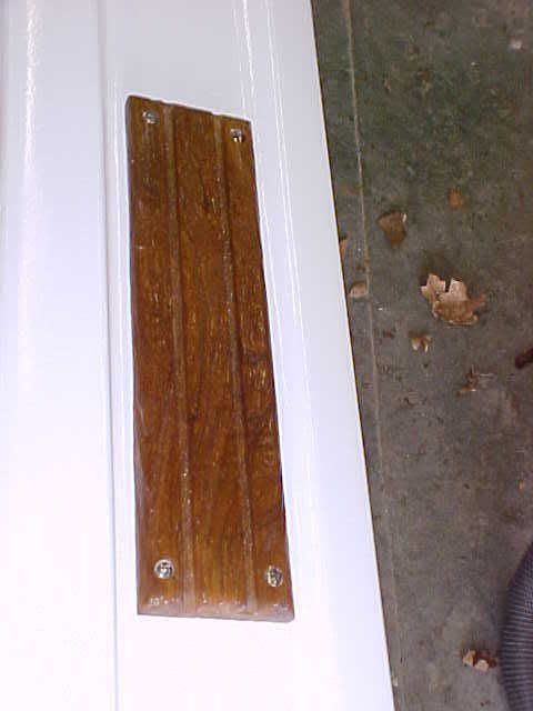

Here's the end result....got to keep mama happy ;) ;D

With the Cetol you don't really need to sand out all of the gray.  Just get the old finish off and you'll be ready to go. The Cetol provides its own color.
